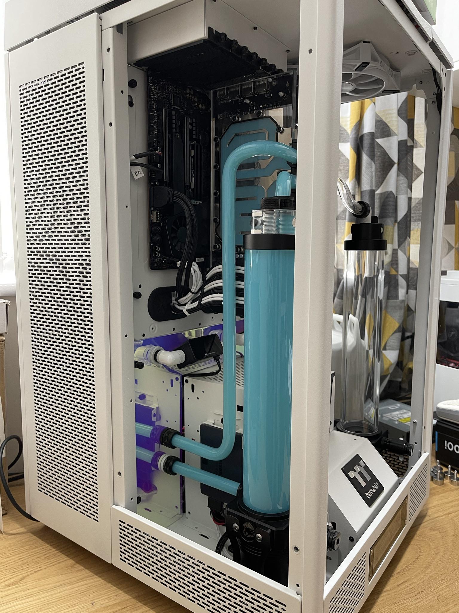

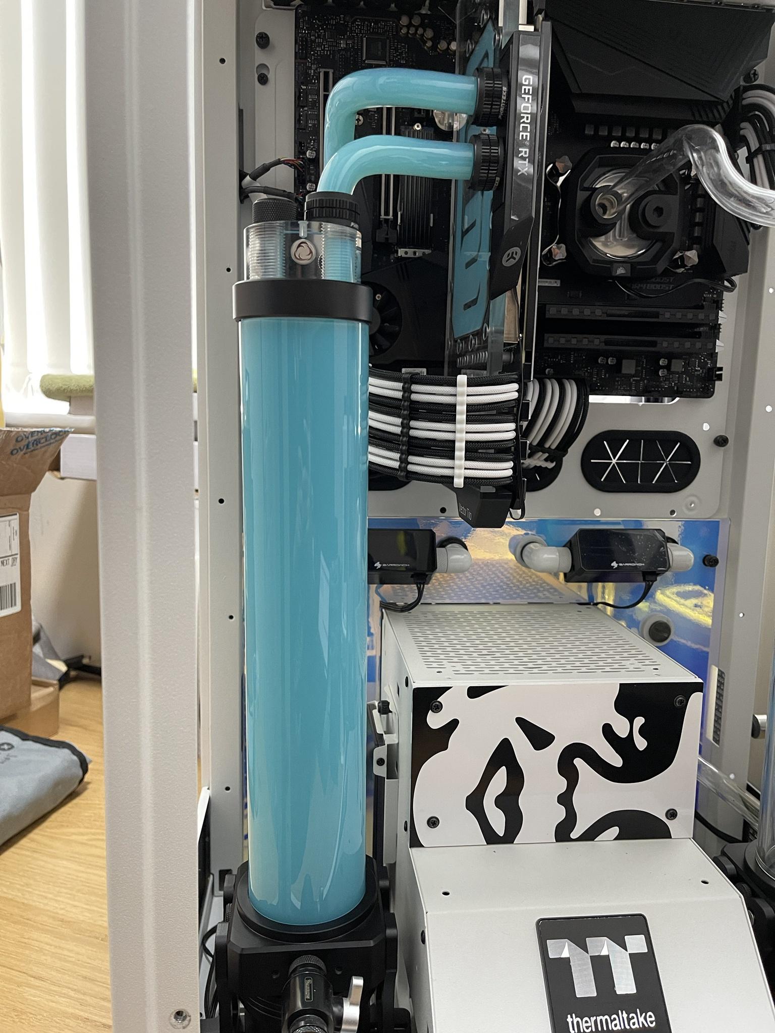

Heres my rig with XTR White on the GPU loop, I didn't bother changing the fluid on the CPU block due to the amount of time it took to prep the GPU loop (almost 5 flushes with an Alphacool Monsta 480 takes ages!).
Its the colour change after 1 year of use, the change did come in effect after a few months but just didn't get around to changing the fluid. I did get in contact with the new owners of Mayhems and Daniel the co-owner was great and sent out some replacement fluid (not XTR) and a blitz kit. I did come across someone else on reddit who had a similar issue to me where the fluid ended up like a sludge after use but didn't end up turning blue. Could have been a bad batch.
