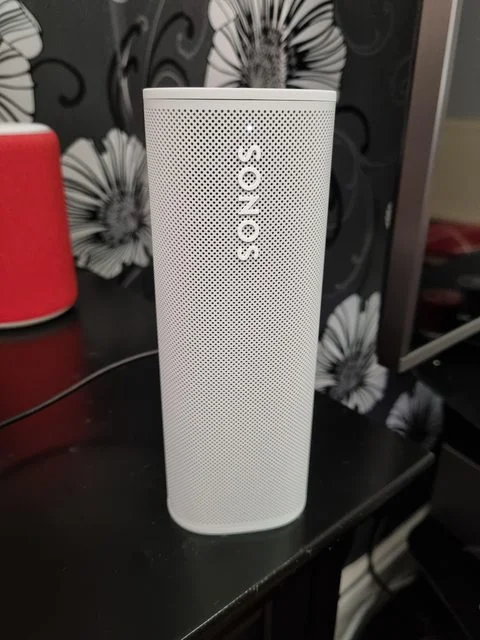

Picked up my Roam today from Richer Sounds.
First impressions are it's smaller than I expected but the sound is fantastic, it's well built and so far seems to work well with no issues found yet. I don't have much that size/type to compare it to other than it sounds better than an Amazon Echo.
