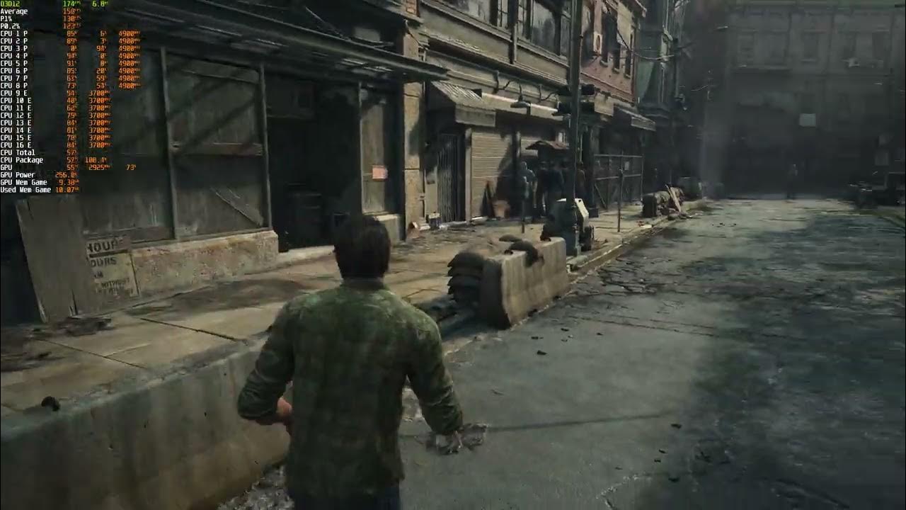

@Wolverine2349 Look at the below,, imagine what would have happened if I turned off Ecores
Yes I see a pretyy good load on each core. It would be bad if e-cores were off in that situation as all P cores pegged to almost 100% or maybe 100%
What game is that? Is that the Last of Us Part 1. Or is it a recent (as in last 3-5 years) Battlefield game)?
