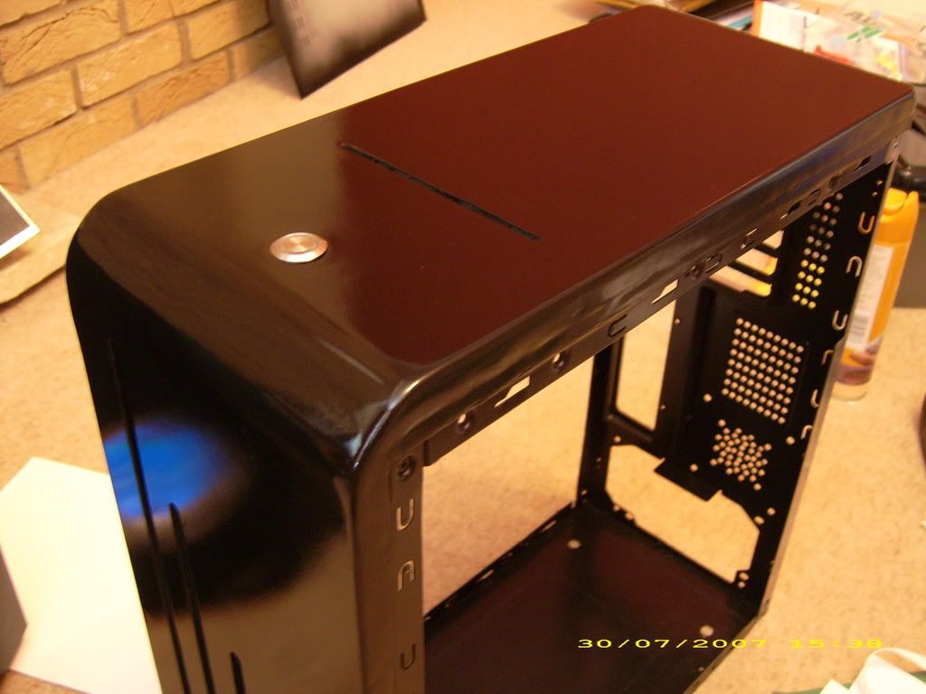

operation: upside down/ reverse case (kind of)
camera phone, sorry!

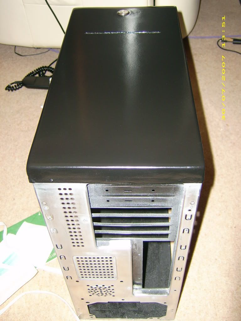

slot for the drive that i still haven't got and pilot hole for power button done
and then some filling and priming and sanding and zzzzzzzzzzz :o
im getting a bit bored of taking pictures in the same profiles! need to get more creative with my photography!
well i hope no one thinks its too shiney, could buff it up but it almost looks artificial!
need to clean up the back a bit and sort out the fan options.
could do with a good dust down at the bottom too!
might be able to actually get some kit in there this week, hurray!
that's immense....god i'm tempted to try modding something like that, you got to love how simple it looks.
I was going to get that button for my case until I decided £12 was a bit much for a button :P
It looks cool - is the top corner fully rounded because in photos it appears to go 45 degrees - straight 45 degress if you know what i mean.

£12 is cheap! but i paid even less so yippee!!
its curved but its a nightmare to photograph so thats why it looks odd. in 3d its so much better to look at.
