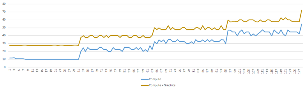

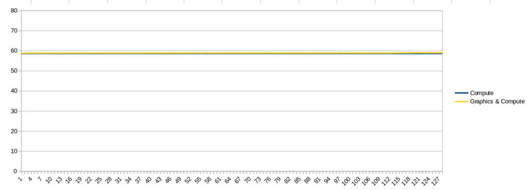

Direct Compute and Shader Combined rendering latency
GTX 980TI, a clear delay here
Tahiti (GCN 1.0) 7970 / R9 280, nothing, nada, nichts..... absolutely simultaneous and parallel. That looks like AMD HSA for GPU's at work here, awesome.
Those are interesting graphs, being that compute plus rendering is higher than just compute on the NVidia graph, we have to assume that the higher the score on the vertical scale the worse it is, which doesn't say a lot for the AMD graph with a score nearly double the NVidia one.
Not saying that AMD's GCN doesn't use Async compute much better NVidia Maxwell, just saying that those graphs don't really make AMD look too good. Great that there is no added latency when you do rendering and compute on AMD, but the latency is twice as bad to begin with, according to those graphs.
Keep in mind it's a 7970 v a gtx980ti. The gtx980ti compute + graphics line does eventually get upto 60 the same as the 7970.
keep in mind also that all gxn products perform about the same on that test. From laptops to Fury X. Test is still way too light for GCN to get any slowdowns.
Its already been pointed out.... but i was going to say that is a 7970 vs a 980TI.
