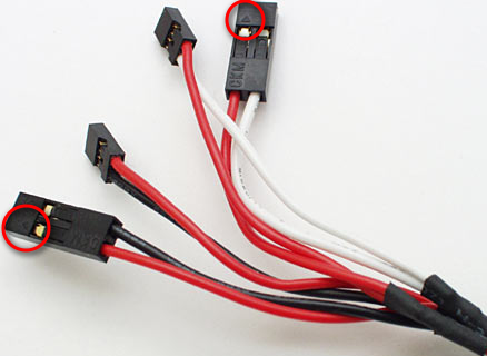

It would be unusual for both power and reset button to be borked. If you look at the black connectors you will see a little raised inverted triangle indicating the positive (if they're not labeled +/-) - make sure you have orientated the cable correctly and connected to the + and gnd on the motherboard correctly.
EDIT: Now on a PC - added pic for clarity
Both power and reset have a positive and a ground - they essentially do exactly the same thing - bridge/short the pins on the board briefly - one set of pins causes the system to boot, the other to reset/restart.
Try again, and be sure to be using the Reset button as your 'power on' case button as this is the wire/s you've essentially rerouted and now reappropriated as your case 'on' button.
