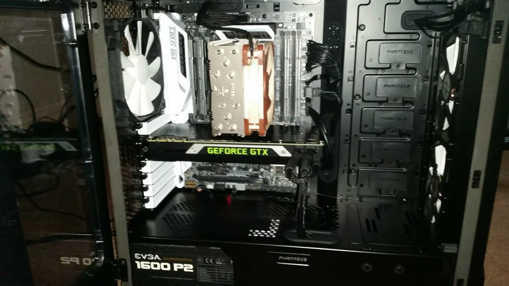

A quick internal pic of my mATX Evolve for those who dont read the project log subsection. Not finished but getting close.

Nice build

What's that big think in the middle with the fan bolted to it.?
Sorry who are you asking that to?
