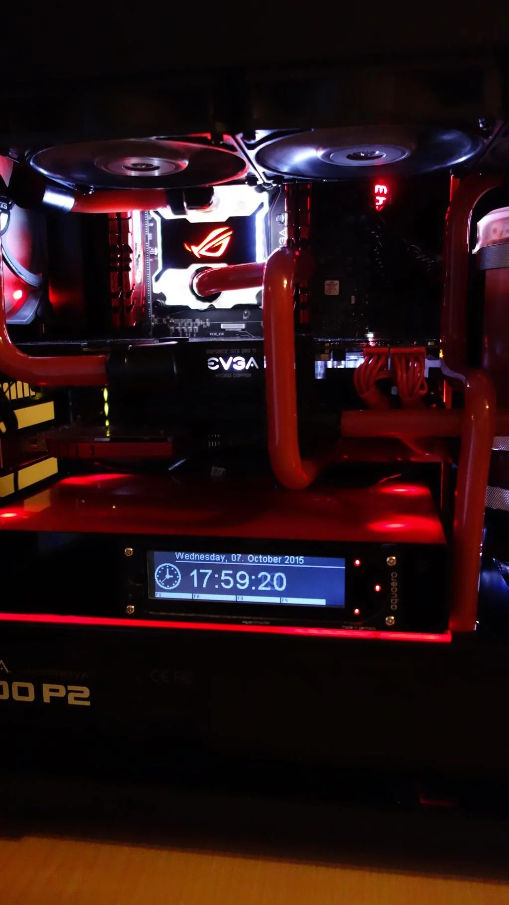

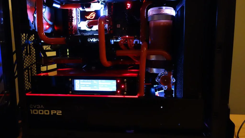

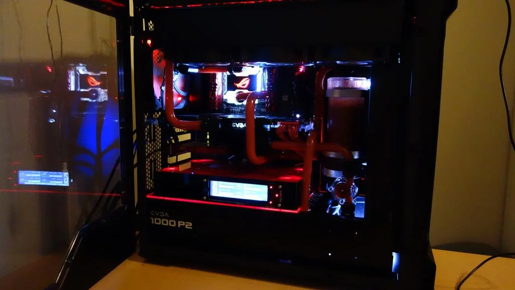

Very nice indeed!
If I remember I'll take a few shots of mine :) What kind of temps are you getting?
My 4790k will hit 78c depending on the game but my CPU cooler needs placing for sure. H100i is now easily 2 years old. MSI 980Ti 6G tops at 65c :D Love it!
Pretty similair temps to what I was getting on the 4790k and 6g snips. And iirc my chip was running a much higher vcore than yours for 4.7ghz.
