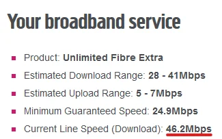

Has anyone ever experienced a problem where your line appears to have a hard download throughput limit imposed on it?
My line syncs at ~52.5mbit and my maximum data rate is ~50.4mbit, but if I download anything from anywhere (and run speedtests) I cannot get anything more than 44mbit.
When I was on TalkTalk prior to switching to Plusnet I used to get the max download speed and nothing on my side has changed.
6. Data rate: 9805 / 50400
7. Maximum data rate: 9804 / 52741
8. Noise margin: 6.1 / 3.4
9. Line attenuation: 33.9 / 23.0
10. Signal attenuation: 33.7 / 20.6
EDIT: Maybe my line is "banded"?
