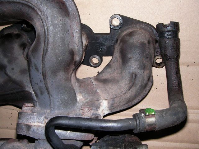

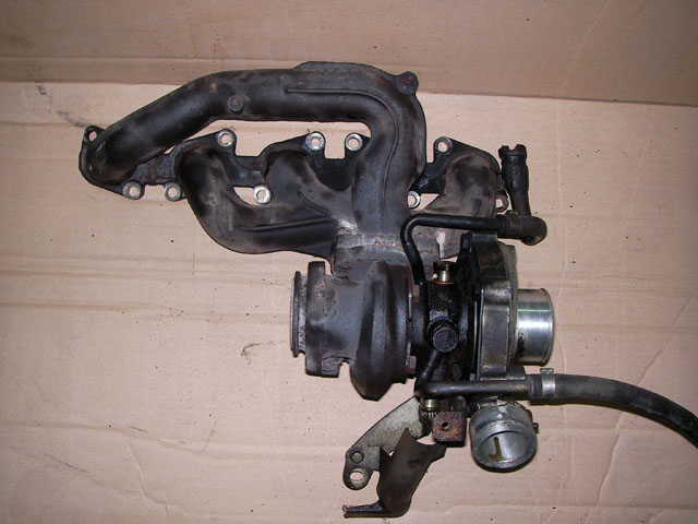

This is what the turbo and manifold looks like. The black oily mess on the core and compressor housing is actualy from the crack, the engine was pushing so much oil through the exhaust the stuff that was forced out of the crack plastered the turbo (handy hint Cillit bang does a good job on oil, BANG and the oil is gone).

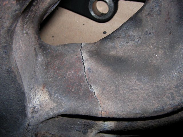

This is where is seems to crack

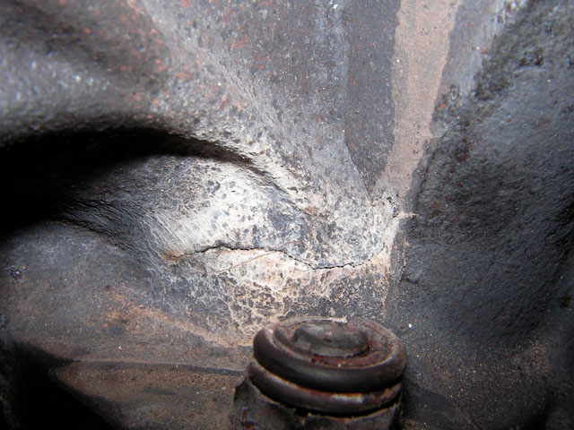

A close up
And just my luck, I get two for the price of one :rolleyes:
This is just above the turbo flange, dosen't seem too bad.
I repaired a friends manifold from his volvo (5 cylinder..) a while back just using my MIG welder, rather than using the special rods in an arc welder as you are supposed to. However, it's held together for a good 18 months so it does work. I baked the manifold in our oven set to max for an hour to try and prevent cracking. Lets just say that if you are married, wait until the other half is away for a few days as it stunk the house out big time.
