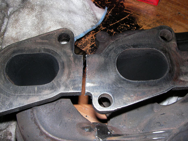

This is where is seems to crack
Yep, thats a bog standard Fiat Coupe crack you've got there.
The new manifolds have a cut out section so that branch of the manifold isn't so rigid and prone to cracking. Like this...
Thanks BO, that makes sense. I need the head back before I can weld it up, but I shall apply the hacksaw in the relevant places. I might also open up the fixing holes a little on the flange for that branch to stop the studs constraining it.
Thats exactly where they cut the Uno manifolds.
Between each port. Stop that plate that bolts onto the head (hottest bit) expanding and prising a crack apart where it did.
You don't have to cut a massive amount of metal away, just a gap in there the width of a saw blade is enough. Keeps as much are as possible to make the seal.

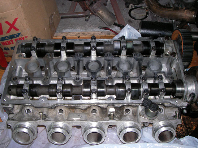

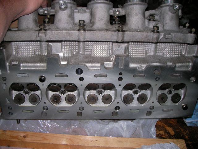

The head is now back from the machine shop, nicely cleaned and skimmed with new guides and seals fitted and seats recut. One job I am happy to pay for.

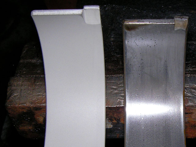

I've also got a new set of big end bearings. They weren't badly worn, but it seemed like a sensible idea to change them whilst the sump is off.

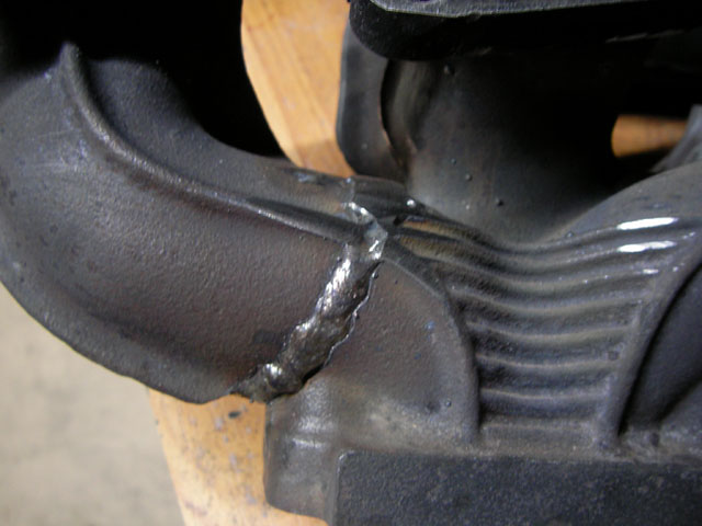

I also spent a little bit of time on the manifold, veeing out the cracks and welding them up. Not my neatest ever welding job, but the results aren't too bad considering this is mild steel wire welding cast iron. You don't see it when it's behind the heat shield anyway :)
The flange between cylinders 4 and 5 has been cut to match the newer style manifolds from Fiat, and inline with the Fiat Uno manifold cracking solution. The welding obvioulsy induced some stresses into the manifold as the cut pinched up near the end and I shattered a brand new cobalt hacksaw blade :( Hopefully after a few heat cycles on the car any stresses should work their way out.
Liverpool-Lad said:
Nice job on the welding, looks tidy!
It went a bit nasty near the top, hence the ground down section you can see (B&D powerfiles are very handy!). It was a bit awkward to get the end of the nozzle in there, so ended up welding at a bit of an angle.
