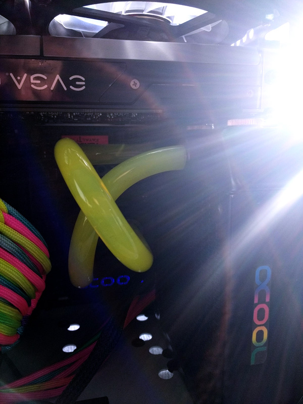

Next I fitted another fill/drain port at the rear and added the pastle coolant.
And it was all looking great until......
I noticed a small spot of coolant on one of the tubes.
I wiped it away as I thought it was just a small drip that had leaked onto the tube from the bottle but as i wiped it away again the drip came back.
I left the pump cycling for a few minutes and no more drips occurred, some thing weird is going on!
So I grabbed some isopropyl alcohol and rubbed it over the suspect area and not only did the drip come back but it was now a very visible hair line crack in the tube!
fluid was now rapidly dripping from it.
So I've powered down and drained the loop. Really glad I added the second port now and draining was fairly painless.
This is what happened when I removed the tube.
I'm guessing that when I swapped the rear fan that attaches to the rad for the new RGB fan it put some extra stress onto the tube.
Another thing is acrylic tube is very rigid and brittle and it has little to no "flex" Unlike PETG tubing that will "flex" a lot more once bent.
The alignment of the tube must have been a bit off putting stress onto the tube when I fitted it.
So now I'm left with only 2 spare tubes to get this bend redone and going on past experience it's not looking good.
