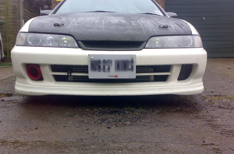

Here's some quick and dirty pics I took today, car still needs a damn good wash/polish.

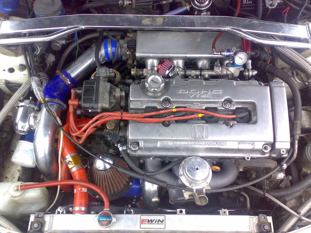

Engine finished:

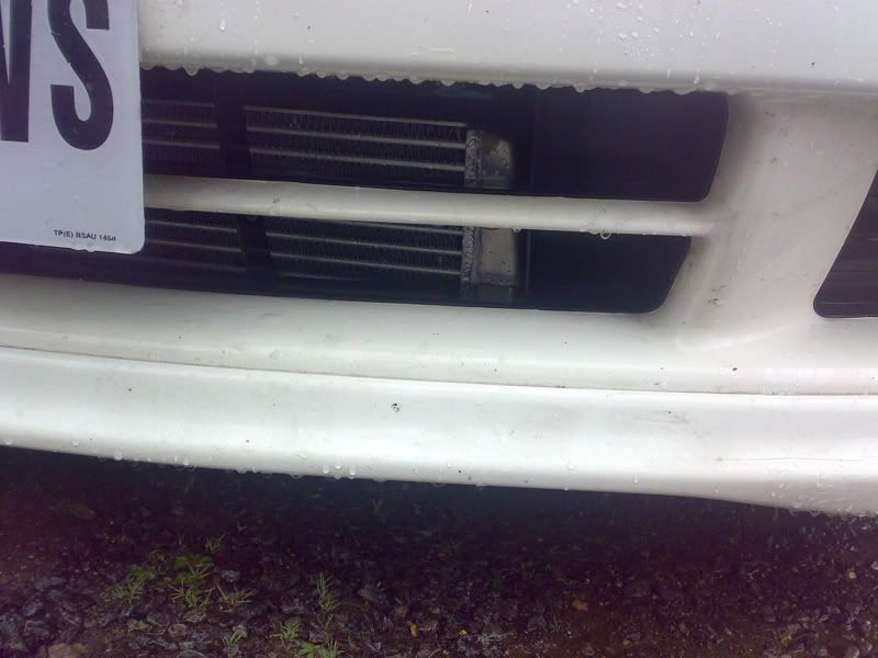

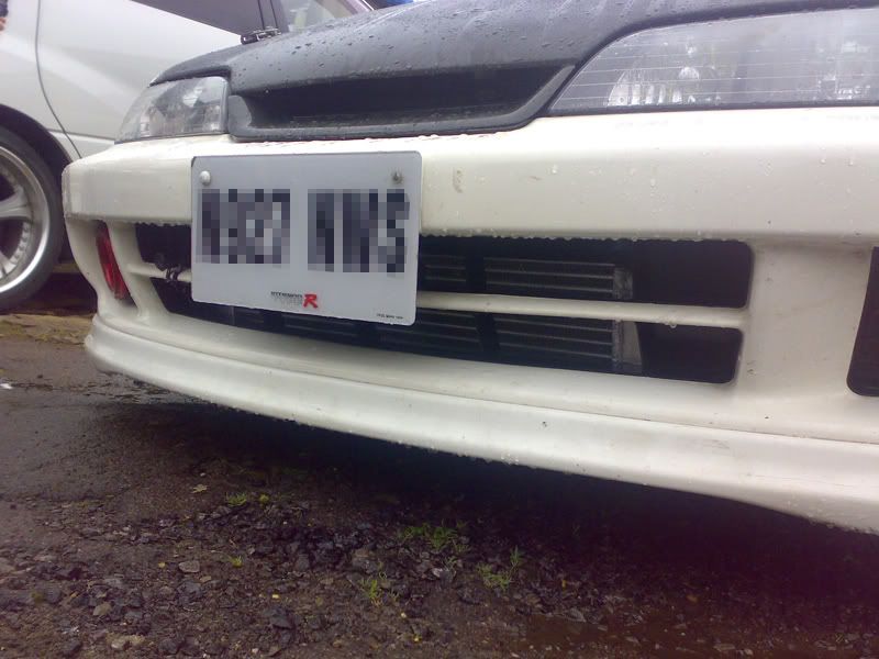

Intercooler looks nice and subtle:
I was amazed at how easily the bumper fitted on with the IC in place. I just had to trim a small bit from the bottom and it bolted right on :cool:
BTW don't expect the engine to be all bling and shiny at Japfest. It looks cleaner in pics than it really is :o
