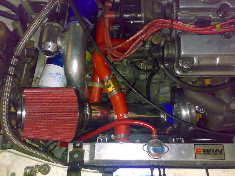

Quick update, car is back up and running now. I've given the engine a quick cleanup, fitted a new throttle cable, and moved the expansion bottle downwards and fitted a new air-filter in a better location (crap quality pics I'm afraid):
As you can see the engine needs a proper clean-up, but it's not too bad now.

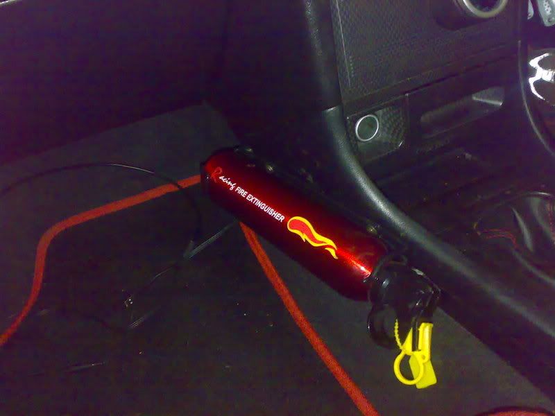

I also bought and fitted this:
Just incase......... :o
