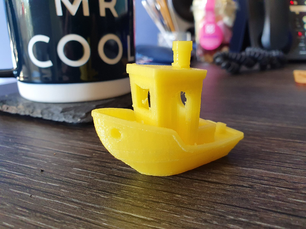

(I have a magnetic surface I just whip off when done).Dimensionally it's looking grand, nice job. It's not the smoothest print so I think you might have some over-extrusion going on now, but you're not going to get completely seamless prints simply because you're squirting layers on top of each other. Of course, the finer the layer height, the less visible it'll be.
That's my test doggo after a few hours tuning up the printer last year. It's mental though with a 0.1mm layer height and about 40mm/s speed, took about 4 hours and it's only around 50mm tall. That's insane quality though, and for functional and structural stuff you don't need to be quite this refined.
Those LED holders I printed for Asteria II took 14 minutes for the pair. Only 6mm tall and about 12mm long, but again was 0.1mm layer height and a sedentary 20mm/s print speed because I needed the precision.
Also, you won't need the masking tape to print on once your temperatures are in check, although if you don't have a removable build plate it'll be a pain to remove well-adhered prints(I have a magnetic surface I just whip off when done).
Will spend more time tuning that bad boy! Left him printing over night. Think I was running just a bit too hot on the bed and not quite hot enough on the nozel.Can't blame you for being excited with your new toy lol@Illuminist - I recon my boaty is better than the boaty from their $95 printer! I left it overnight and this is exactly what she looks like this morning.
I recon I can get it better still as wellWill spend more time tuning that bad boy! Left him printing over night. Think I was running just a bit too hot on the bed and not quite hot enough on the nozel.
BOATY!!!

Boaty!!@Illuminist - I recon my boaty is better than the boaty from their $95 printer! I left it overnight and this is exactly what she looks like this morning.
BOATY!!!

Jesus wept, I had better prints on my Ender before she was dialled in.Benchy McBenchface! I've never actually printed a Benchy...the printer does need firing up again soon, so perhaps I shall this time.
I watched that Linus video and cringed when his perceptions were skewed because of that mental Ultimaker he has, and then laughed heartily when his Ultimaker comparisons were just ******* shockingJesus wept, I had better prints on my Ender before she was dialled in.
