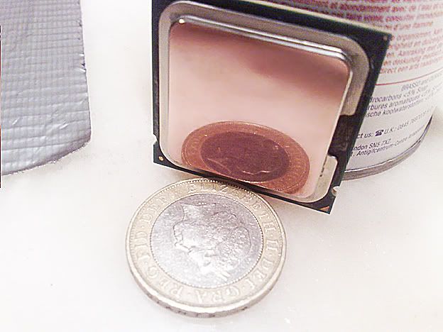

Did mine the other day due to bad temps and uneven temps across the cores (7c difference between core 0 and core 2!) with an average of 58c load iirc @3.6ghz under water. The IHS was worse than my e6600's the edges were raised and the centre was also convex which would have been ok for e6600 but not for quads. Its not in my system yet as I'm waiting for a PSU so I'll report back with any differences found. Here are a few pics of the results after 30 mins of lapping.
That looks lovely mate ;)
So your telling me you got it that shiney in 30 min?
Yeah - bear in mind I this is my 6th or 7th cpu I have done now so I've had a fair bit of practice;). Not to mention lapping various waterblocks that were scuffed up.

I get better results using the paper dry (which btw is 'wet and dry' not sandpaper). You don't create enough friction to cause any heat and the water is only really used to lubricate the paper and as a handy by product prevents dust but for some reason I can only get a dull shine when its wet not a 'chrome' finish as seen.
I doubt you will get it done in 30 mins if its your first attempt so allow for an hour or so. I use a the glass out of a picture frame but yeah anything flat will do (glass/mirror/perspex etc).
The trick is using the right amount of pressure. A fair amount is ok in the early stages as the scratches you create will be taken out later on. The early stages (400/800) are only to get the plating off and make it flat. The rest of the stages using very fine paper is to get the shine which isn't required unless you are a bit anal like me and wish the chip to hold some value.;) In the last stage just let the chips weight apply the pressure.
Don't forget to clean the cpu after each stage removing any contamination from the grittier paper - many forget this and wonder why they get lots of scratches.
