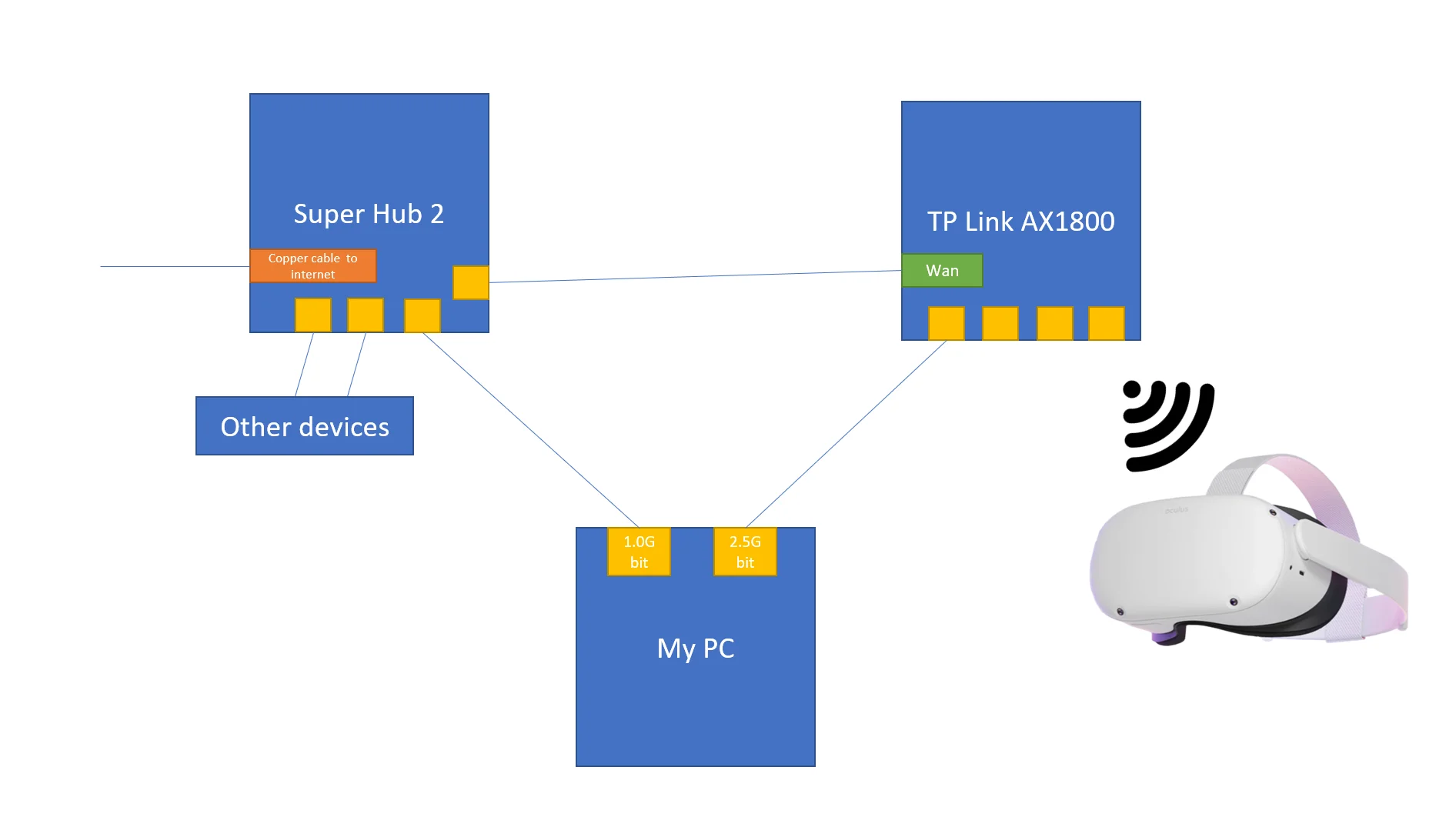

Folks, I asked the question in networking forum about the below and was informed I should take the cable running from the my PC to the AX1800 AP.
Do you think this will impact the latency if I do this?
1. You don't need a cable going from your PC to the Super hub. So take that out.
2. You have the AX 1800 setup as an Access point, yeah? It's only for the Quest 2? If so then you should connect the the cable from the Ethernet port on the super hub to an ethernet port on the AX1800, not the Wan port.
3. If you don't have the AX1800 setup as an access point, set it up as an access point. And return to Step 2.
Don't over complicate things, if at all possible.
Yes Ive got the AX1800 setup as an AP. But I was under the impression that connecting it into the router would cause some conflicts with DHCP/nat setups.
Im definitely with you on not complicating things for sure melmac.
(Will give above a try in a few mins).
If you have it setup as an access point it should turn off DHCP and NAT. Just make sure the connection is from Yellow on the Superhub to Yellow on the AX1800.
So I tried it as you recommended melmac, seems to work well!
Only thing is I cant access the TP Link settings anymore, Im putting in the tplinkwifi.net address or the Ip address to get to it and I am not able to....
Any idea why?
I think I've managed to get around it by setting up a statix up address to the ax1800 and forcing DHCP off. I should force NAT off as well I guess just incase?
