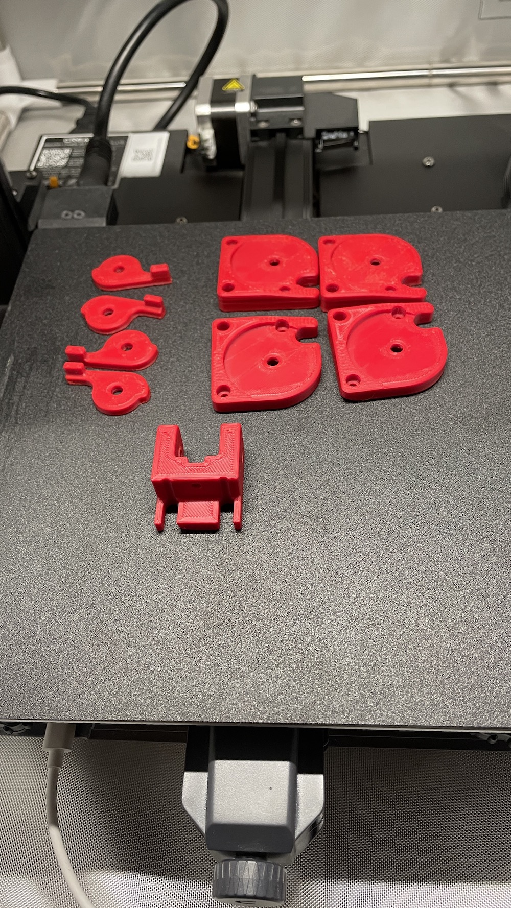

So some success today printing the Voron 2.4 accent parts. On the first part I printed this morning I had no part cooling going, as per the ABS profile in Pusaslicer, and the last few layers, it was one of the belt tensioners top left, were deformed. I set the fan to 10%, that solved that issue and the 4 I then printed were fine. I then printed the first of the 4 z drive baseplates and that suffered from minimal warping. All the parts printed to this point were printed onto a textured PEI sheet so I swapped back to the non textured sheet that came with the printer and printed the remaining 3 with no warping. I printed 1 of the 4 z tensioners and decided to call it a day.
Couple of things. One is the top layer on the prints seems a bit rough so I shall play with temperatures tomorrow and see if that makes a difference. Another is the colour. I'm just not sure I like it enough to use on a £1500 printer. I wish it had been a bit of a brighter red but I need to print one of the corresponding parts that will be black to see what I think. Picking red or green as a colour scheme is fraught with peril as I'm red/green colour blind. If I can get a spool of eSun ABS+ in yellow I might swap the accent parts to that and call the printer, when it's build, Bumblebee.
Also the smell given off by ABS, well contained in the enclosure until I unzip it, seems so familiar to me but I've never worked anywhere that would have melted ABS sop not sure why it's familiar.
So it's all going reasonably well on the accent parts and I am sticking with the red as I like it with the black. The red prints relatively easily but the black is being a bit of a sod for adhesion and warping. I've ordered a Prusa Mini Satin Sheet from Wedge 3D, that should arrive tomorrow, so I'll see how that goes with the black ABS+.
This is a long old process but as I am saving the money to buy the LDO kit, not in stock in most places, and I don't plan on doing this till next year anyway, I have plenty of time to get the printing done.

So I worked out what the issue was on the rough top surface of my accent prints, over extrusion. I've now reduced the Extrusion Multiplier in Prusaslicer and am getting better results. The parts that I've printed that would show the rough surface clearly I will reprint.
I discovered this when I read the Stealthburner instruction pdf, it said 2 of the parts that had to join together wouldn't if the printer was over extruding so when I printed them they wouldn't fit together. Once I adjusted the Extrusion Multiplier and reprinted, they fit like a glove.
I also test printed my first main colour, black, parts for the Z Idler to see if the over extruded red accent parts would fit and they do so hopefully I won't have to reprint many parts.
Though this is annoying, I should have done all this before I started, nay when I got the printer, it's also an enjoyable side to 3D printing, overcoming issues.
