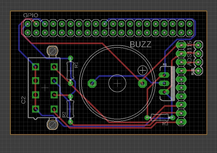

I've been working on improving/adding to an existing project.
Couple of components to locate a little differently for clearance, and another two pin header to accept a button input to add.
In short it's a "HAT" that has:
ADS1115 ADC Board header to accept a two temperature and a pressure sensor (With the necessary voltage dividers to convert resistance to voltage)
A Molex Mini-Fit Jr header for sensor inputs.
4 pin header to connect a 1.3" OLED display
5v Buzzer + N-channel MOSFET allowing me to switch 5v with a GPIO pin via PWM
2 Pin header (To add - button input to change what's displayed on the OLED display)
It should be relatively simple, even if you've never used python before.
It'll be two wires from the reed switch (One to 3.3v the other to a GPIO pin
