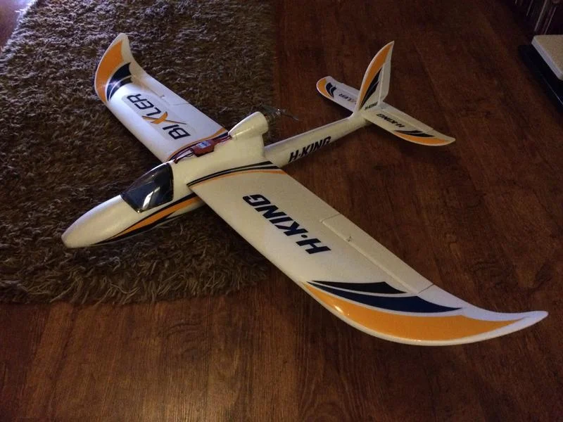

I've actually built a Bixler in the mean time as I figured it would be better to learn to fly on. It's all built, I just need to maiden it but with the weather being awful I haven't really had a chance, Saturday would have been perfect but I had other plans :(

On the wings I have built before, I just used tape, worked very well :) I would not worry about it too much. its going to get bashed about anyway, and will be easier and quicker to repair with tape too.
With the Bixler, I modified the main-spar on mine. I slid a smaller carbon spar inside it, and glued it with Gorilla glue. This made it MUCH stiffer, and much more pleasurable to fly. The spar that comes with it has too much flex imo, which makes it a bit lazy and "floppy" to fly. It also means it will not do anything energetic without the wings flapping about. Its a very simple fix, and really worthwhile :)

Cool, with regards to the wing you're probably right :) it'll probably take a beating so won't matter too much, It'll probably be worth getting another colour so the top and bottom are different for orientation :)
What bixler version did you modify the spar for? mine is a v1.1 and I've seen the v1 and v2 have different spar lengths and configurations.

Not sure what version it was. I just decided after flying the first time it was a bit sloppy and disappointing for such a well received model . So used what I had around to make it better :)
