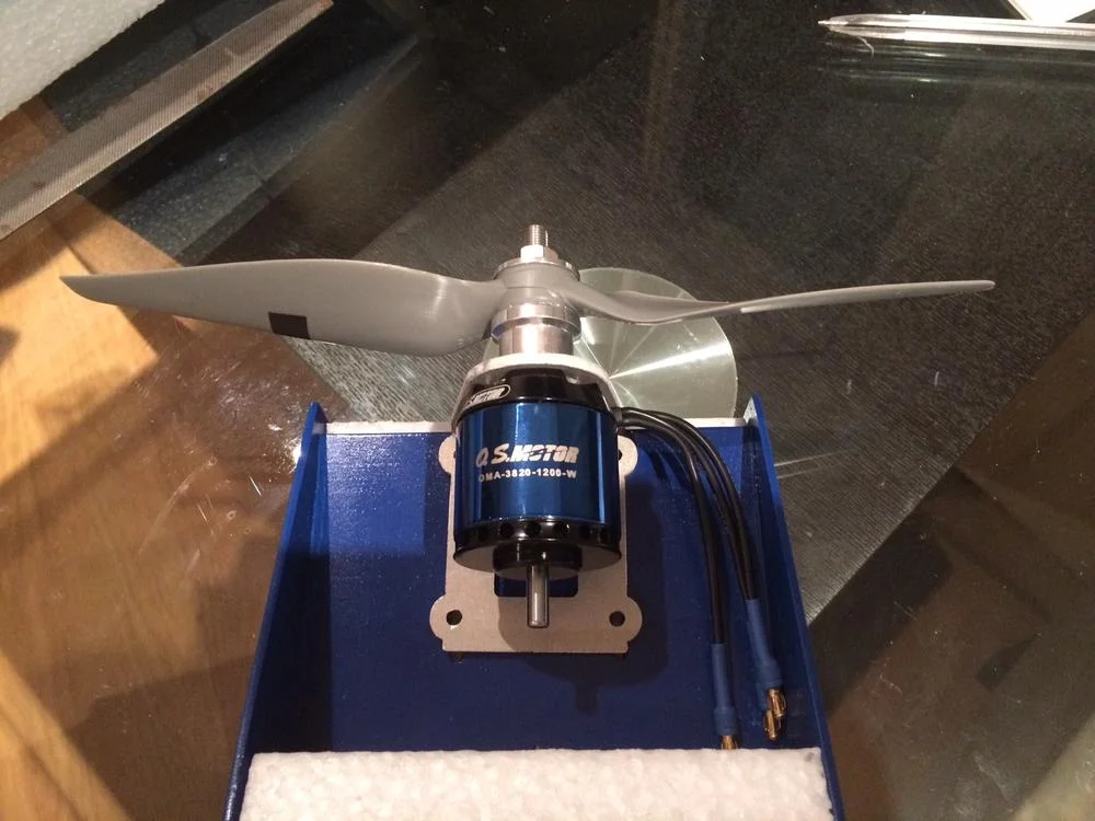

Motor and props came today, O.S. 3820 1200 spinning a 9x6 prop on 4S gives 1025W of power :D

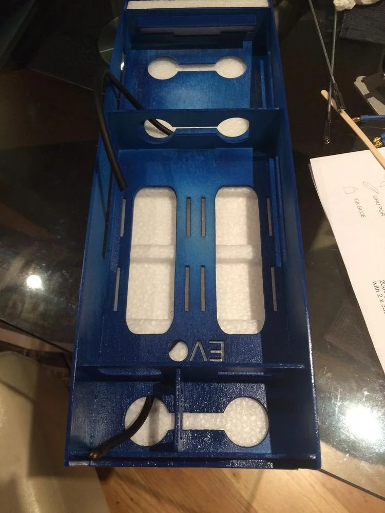

Also worked on routing some shielded cable for the FPV camera.

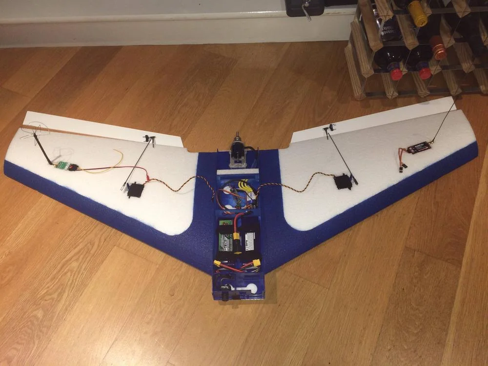

Servos arrived and pockets cut in the wing. ESC programmer card came so programmed the ESC.

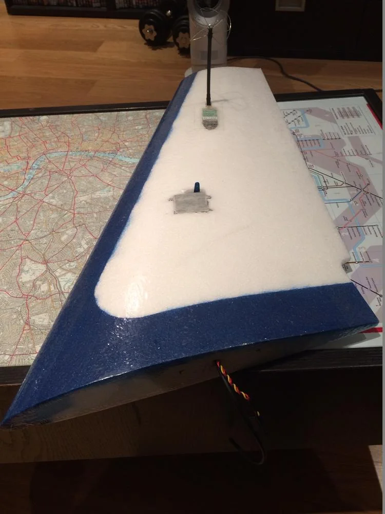

Today the 2.4GHz VTx and EzUHF module came and I've cut their pockets in the wing.

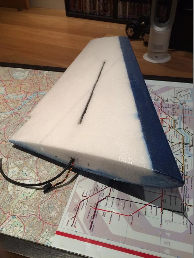

Tomorrow I'm cutting the channels for the cables and making up the VTx cable using individually shielded AV cable. Also going to laminate the elevons.
I'm waiting on some S/FTP Cat6 cable for the Rx cable. Once that's all done I can cover the wings and glue them to the fuselage.
Once the airframe is complete I just need to install the Eagle Tree Vector autopilot and she's ready to go.

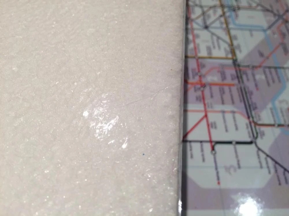

Also either I'm some sort of laminating savant or it isn't as hard as I thought it would be, my first ever wing went perfectly, it's as smooth as a baby's bum and the edges are sharp, only one tiny wrinkle. I actually quite enjoyed it :)
The worst imperfection I have
