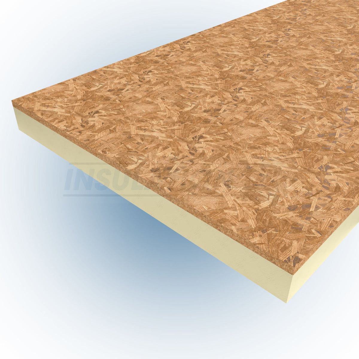

e: thought these were interesting
(yes - no air gap)
(yes - no air gap)

That looks like the , maybe 1" piece of polystyrene I have on the hatch door, but, it's only a few percent of loft area;
