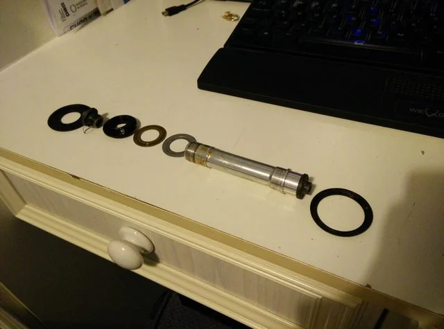

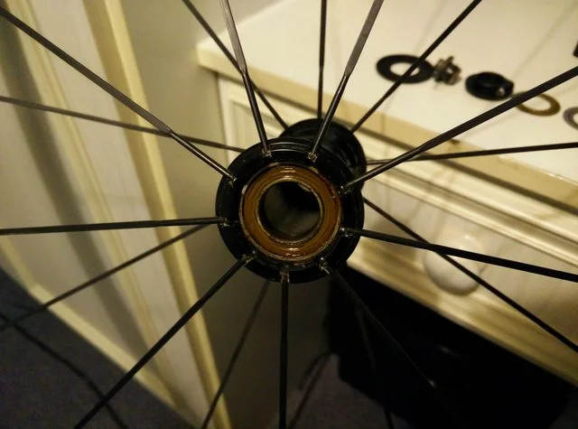

I've had a chance to take a look at my Fulcrum Racing 5 front hub.
Yep, one of the bearings has gone. I've regreased, reassembled and it is still just as bad as it was to begin with. New bearings it is then. Pretty poor after only 5 months of use.

I cant remember if there is a circlip holding the axle in place or just friction. Either way, it's really easy to take the axle out and get at the bearings.
You can knock the old bearings out with a long, narrow drift through the middle of the hub. I think I used an old 10mm axle and a hammer to get the old ones out.
You need to be careful tapping the new ones in. Only apply pressure to the metal outer edge of the bearing. I found a socket in my socket set which was just the right size to rest on the outer edge of the bearing and not make any contact with the plastic shield or the inner metal part.
Take your time gently tapping and make sure they go in straight, dont just whack them in.

Mine (2014) had no circlip. Instead it was a case of pulling/prising the axle end off. The piece I'm referring to is 2nd from the left in my photo.
Everything else then slid/unscrewed off revealing the bearings.
