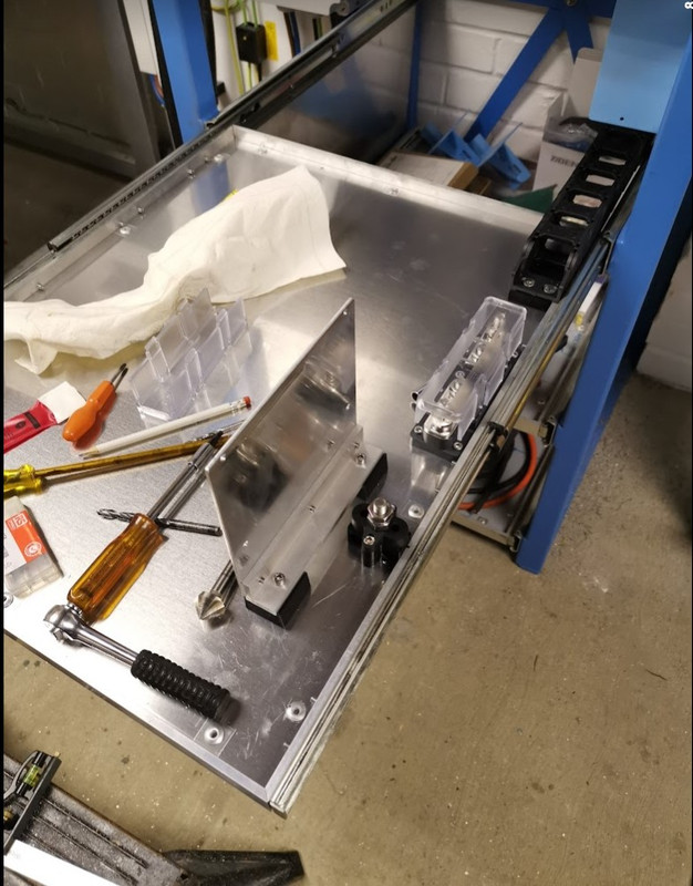

Started building up the second battery tray, cell's aren't arriving until late April, but there is plenty to do.
And also the main rack fuse and busbar.
