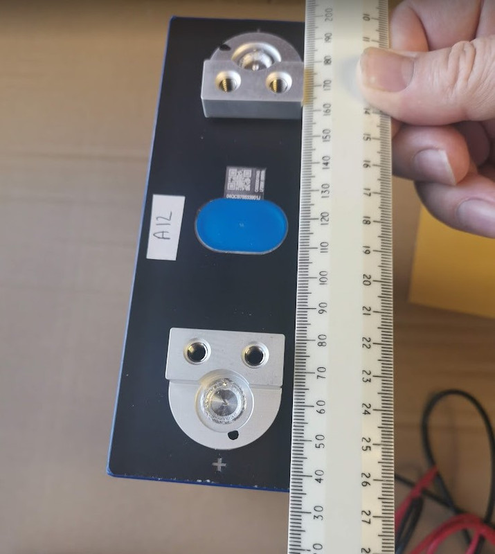

Yes the bottoms of the cells are still covered.
All the cells are physically good, there is no damage, only thing I have noticed is the terminals are welded on slightly crooked, some are worse than others though. I don't think this will cause any issues, as there is some leeway in the supplied busbars, but I may well use these flexible busbars - need to check hole spacing.
I've measured the voltage, and every cell is 3.295v, can't carry out any other checks as I don't have the equipment yet.

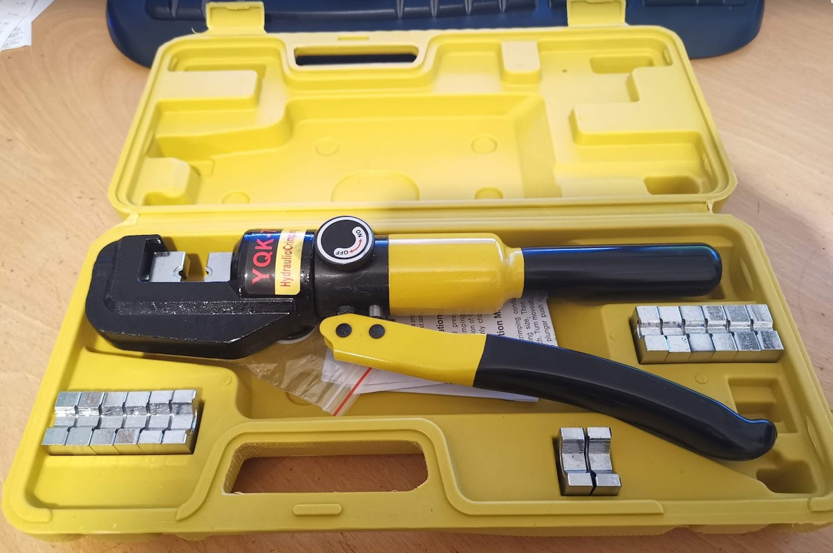

Hydraulic Wire Crimper, next on your list of stuff to buy, it never ends!, if you don't have one already.
I'd go the 16Ton version for the longer length handles, makes crimping a bit easier, you still have to use all your strength :)
A lot of crimping to do.
I asked Fogstar for the EVE test data spread sheet last night, they emailed it through this morning.
My cells range from 290.6 AH to 294.1 AH, if that is the case it will give a 15kWh battery. Once I get my battery tester I will test some cells.
The only odd thing is the spreadsheet has a production date, and creation date value for each cell, all of which are the 15 June 2022, which differs from what the Lifepo4 app says, which is January this year for most of them.
I didn't, I do now though, it arrived yesterday :D Only the 8t one though.

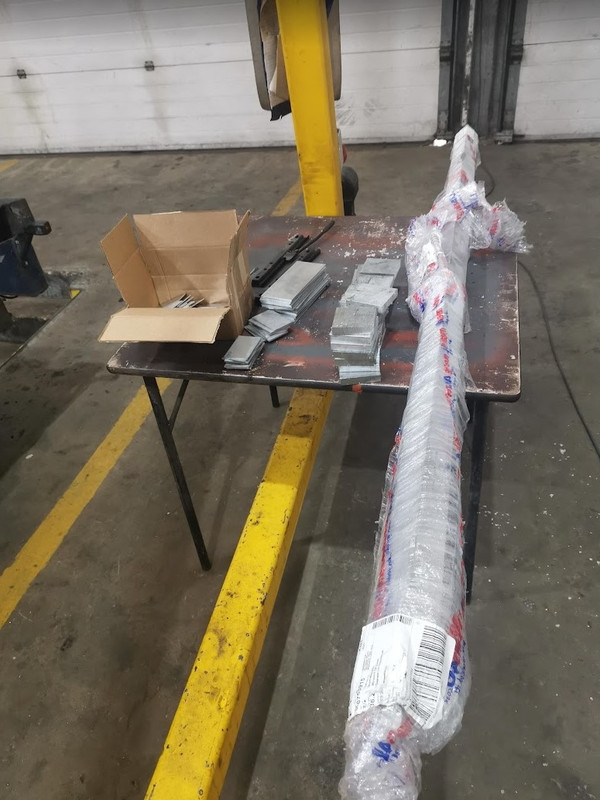

Last night I ordered all the aluminium for my solar mounting brackets.
