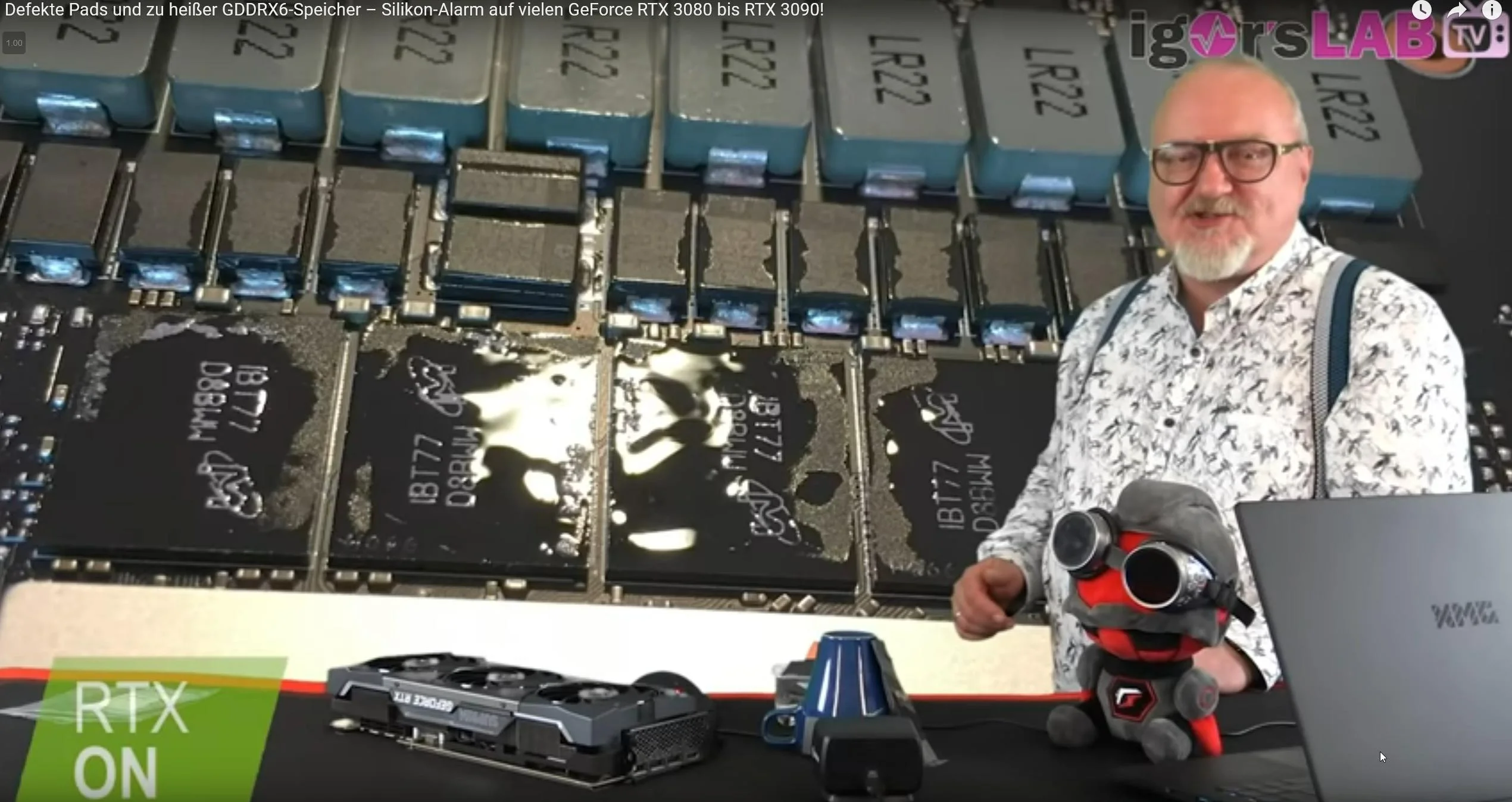

Well, Igor's video on the defective pads:
at 03:29 (don't think the forum lets you link to times) says that about an earlier issue - the uneven main die - Nvidia are totally silent ("Zitronen Lippen", i.e. lemon lips).
I presume they are also not happy with his joke (01:05 onwards) about the melted goo being RTX On either:

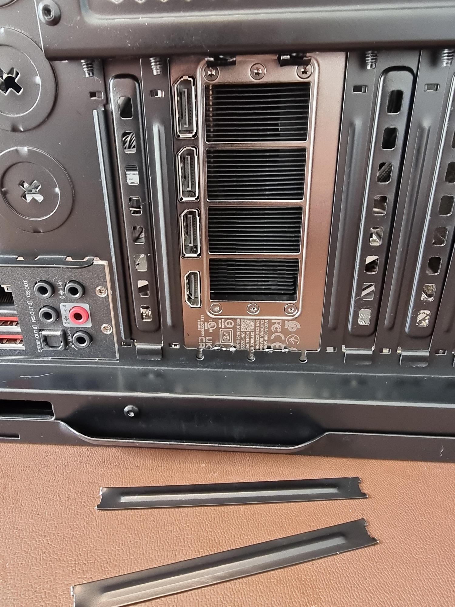

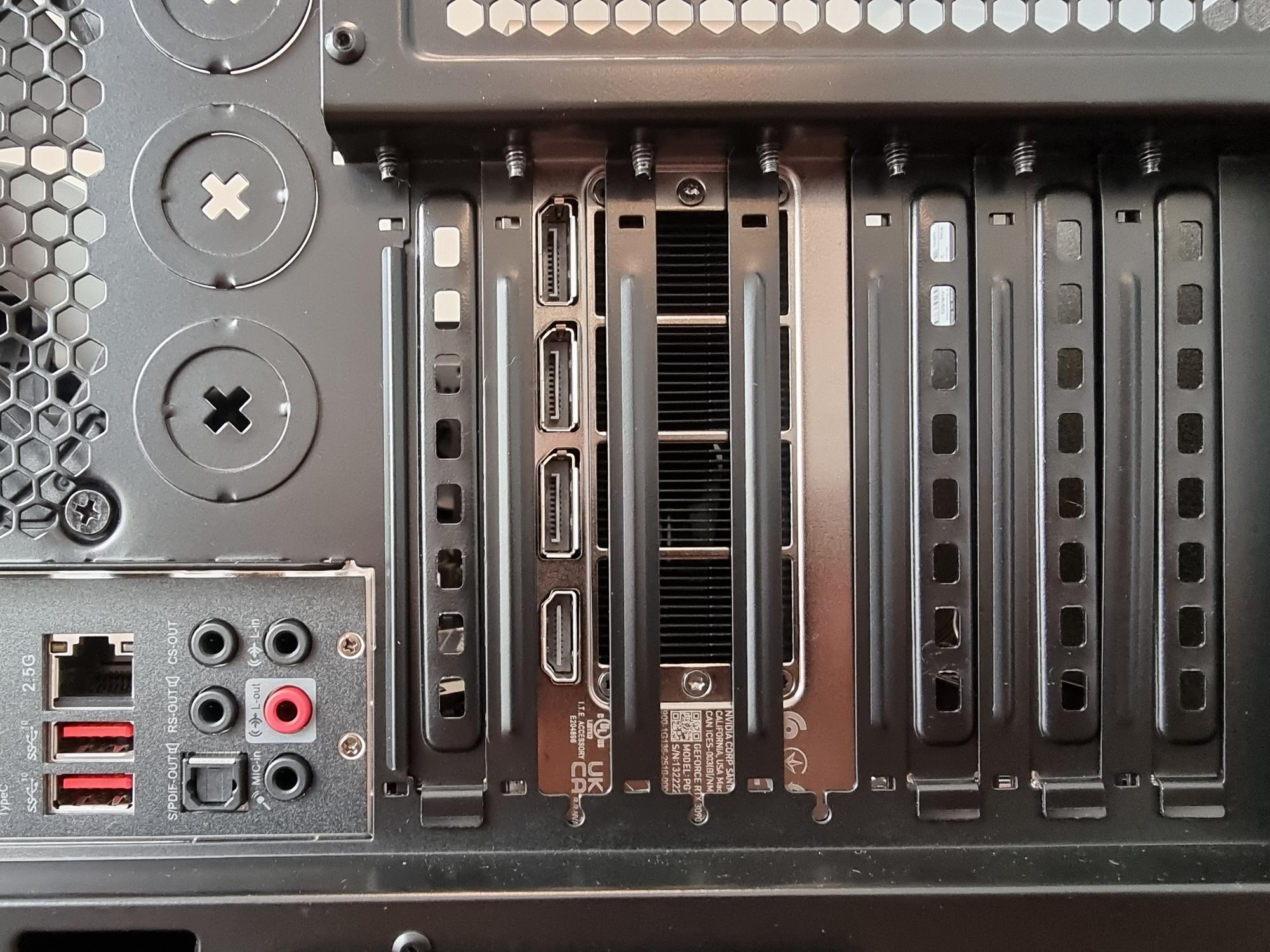

I managed to bag a 3090fe, delivered yesterday.
And I'd not actually thought through how the cards thermals worked until I installed the card and realised the my PC case's metal structure blocked about 50% of the 3090's rear exhaust.
I've ended up snipping two metal braces off my case to allow the 3090 to breathe correctly.
I wonder how many others this affects?
Jobs a fish :D
Did you do any before and after results?
Sorry, I didnt get that far, it was just obvious at installation what needed to be done. From what I understand though, the rear exhaust comes from the underside fan. So having it blocked like that would have easily increased temps I'm sure.
Cheers. I have considered doing this for a while but haven't bothered as I would need to strip the PC down to use a dermel. Maybe one day...
Air will pass through, as its not completely blocked. But having those two metal strips in the way, looks to be blocking nearly 50% of the vent area. So the flow of air leaving heatsink will be reduced, hence a warmer gpu.
Take the card out and use a pair of pliers. It’ll take longer to take the card out than it will to remove those two strips of metal.

Those pads in that Igor video only become trouble at excessive temperatures. While not all pads can turn to goo, limiting their temperature is always a good idea.

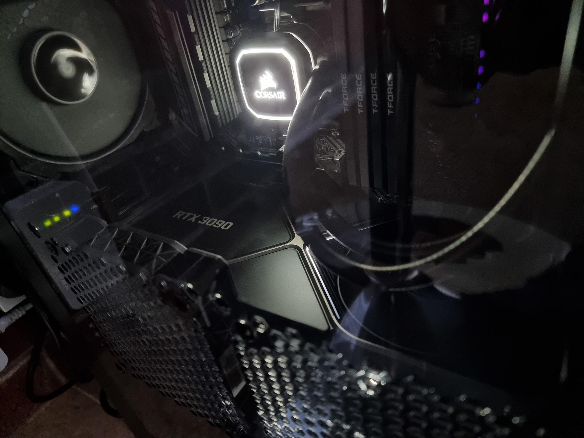

My case and internal setup really suits the GPU blowing upwards, as the top of the case is just open vented, with an AIO blowing out and upwards. I've also got a rear fan blowing out, and a front fan blowing in.
I have added a side fan sucking 'cold' air from the room onto the 3090 through the clear side cover to help move air across the back/top of the GPU.
So 2 drawing in and 2 blowing out.
does it make that much of a difference? wouldnt the air just be pushed out anyway?
Won't be more than 2C at absolute best, and I wouldn't be surprised if it was just 1C.
The rear fan is the intake fan. That brings air directly in. Blocking that fan can raise temps 5C or more. If you have a PCIE sound card next to the GPU with like only 4.8mm of clearance, that will do it (I bought a x4 riser for my Soundblaster PCIE Titanium Fatal1ty sound card and that worked wonders). The fan on the front is the exhaust fan, that pushes air out both through the I/O vents and over the system DRAM memory. So in the end, you'll gain more by improving the intake, than by doing a destructible mod like this. Plus this could hurt resell value of the case and look awful if you ever went back to a 2 slot card, or moved the card to a vertical mount.
If someone had the skills and machinery (and I'm sure there's plenty of people here with lots of income for that), a mod with removeable metal shafts that can be reinserted would be pretty nice but I have no idea how such a mod could be done unless someone had access to a professional machine shop and some nice friends ...
That being said that's why I love Fractal Define 7 XL and Meshify 2 cases. The PCIE slot brackets are large enough next to each other so when you remove them there's no metal bar at all, so mine is fully clear without a mod. Corsair cases (at least their older Graphite series, I don't know about their new 1000D/4000D/5000D+ airflow series) have those ugly bars. So I guess Fractal made the PCIE slot covers wide enough :)

Those are the stock pads. 1.5mm on front VRAM, 1.8-2.0mm on front VRM's, 1.0mm on backside VRAM, hotspot backside strips are between 1.0 to 1.5mm.
I have no idea who the maker is or what the product SKU is (i'd love to know just so I can buy them to mess withi them). But GamersNexus mentioned in his 2080 Ti teardown video, that had one set of the pads looking identical to these completely (the other set looked different), that Nvidia uses Fujipoly (1.2 w/mk??) and Lairdtech or something on that card? But on the 3090 and 3080 it's only one type of pad with different thicknesses. I want to know what that pad is and where you can buy it so I can see just how bad it is (might throw them on a laptop VRM).
