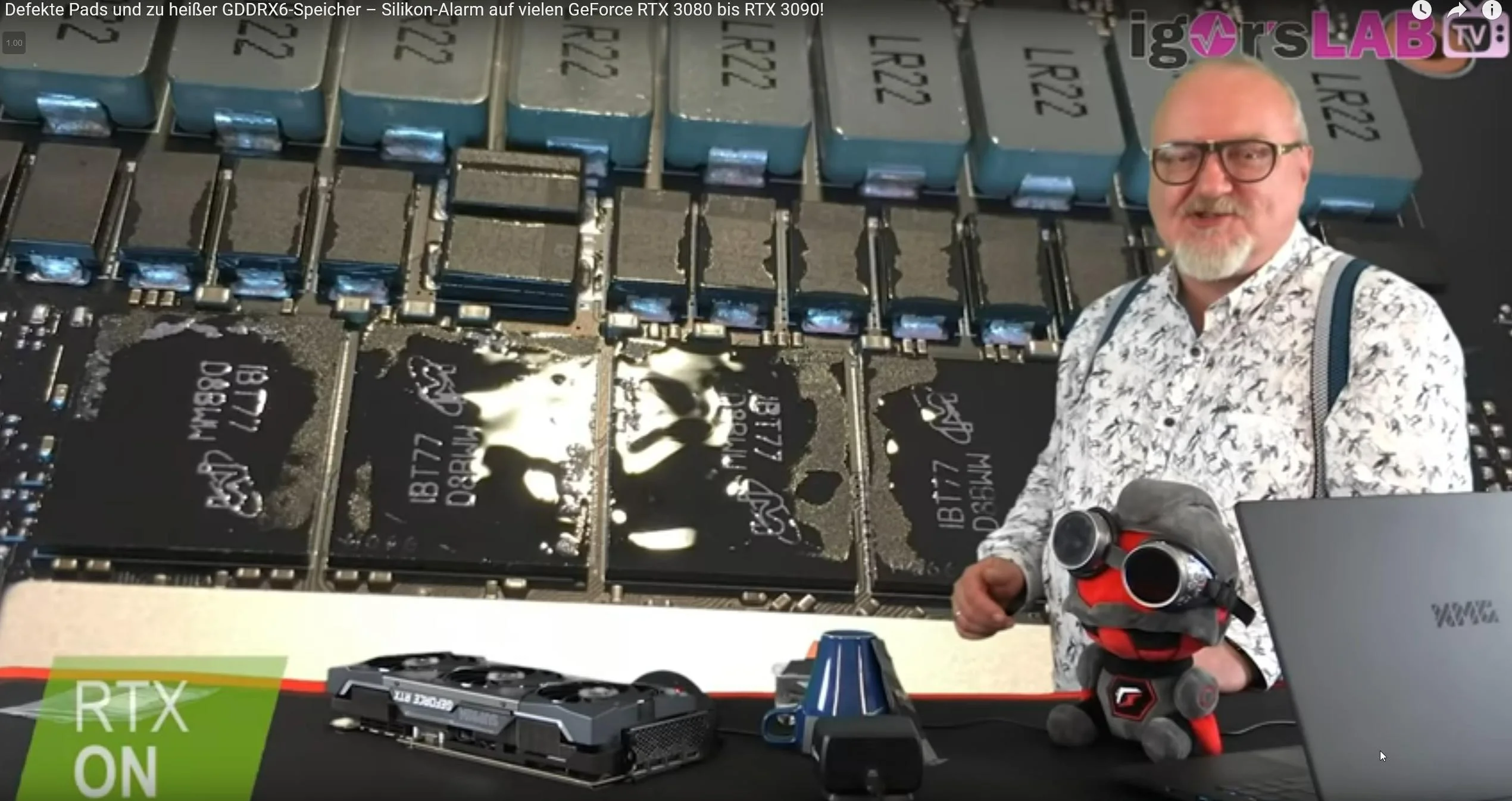

I presume they are also not happy with his joke (01:05 onwards) about the melted goo being RTX On either:
:cry:
Looks like someone had been at the spreadable marshmallow stuff you can get.
I guess the same thermal pads would be on all of their FE cards so does make me think about swapping mine.

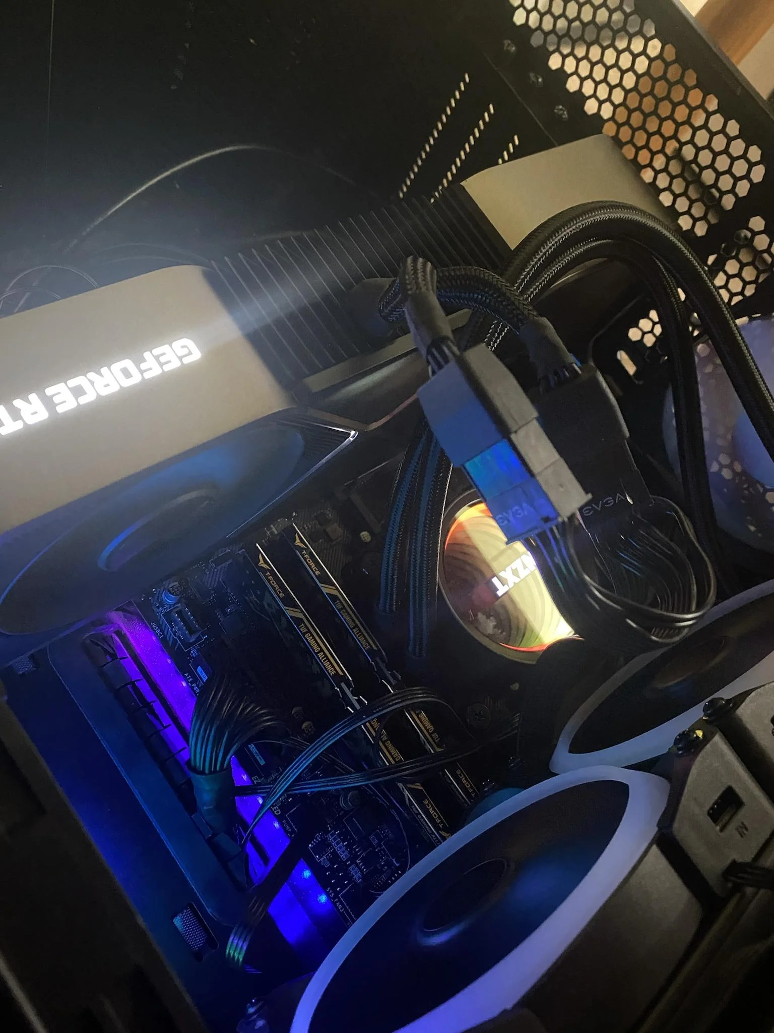

Damn, I feel :o as I never noticed the rear is partly blocked by the case after removing 3 slot covers till I seen this thread.
