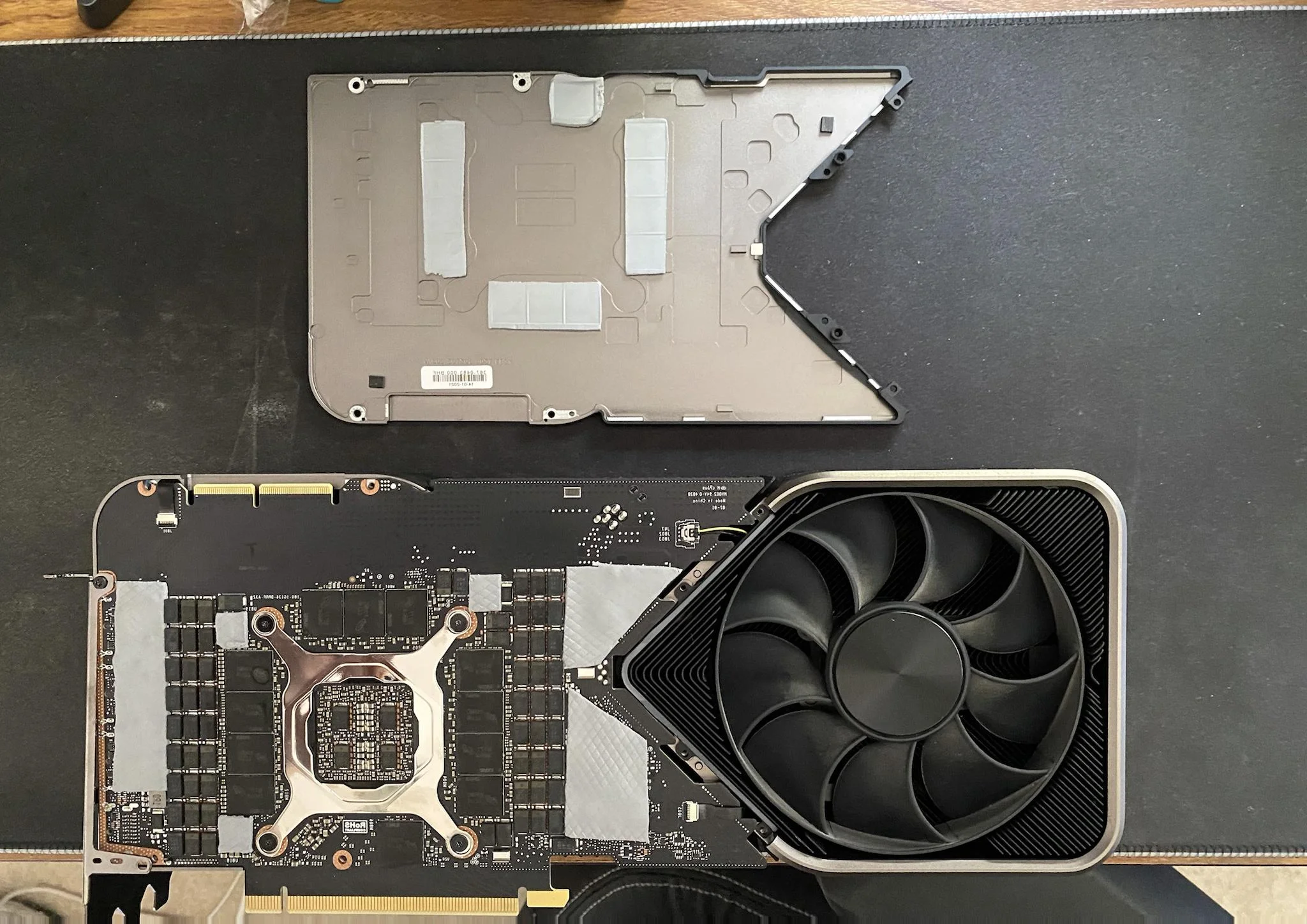

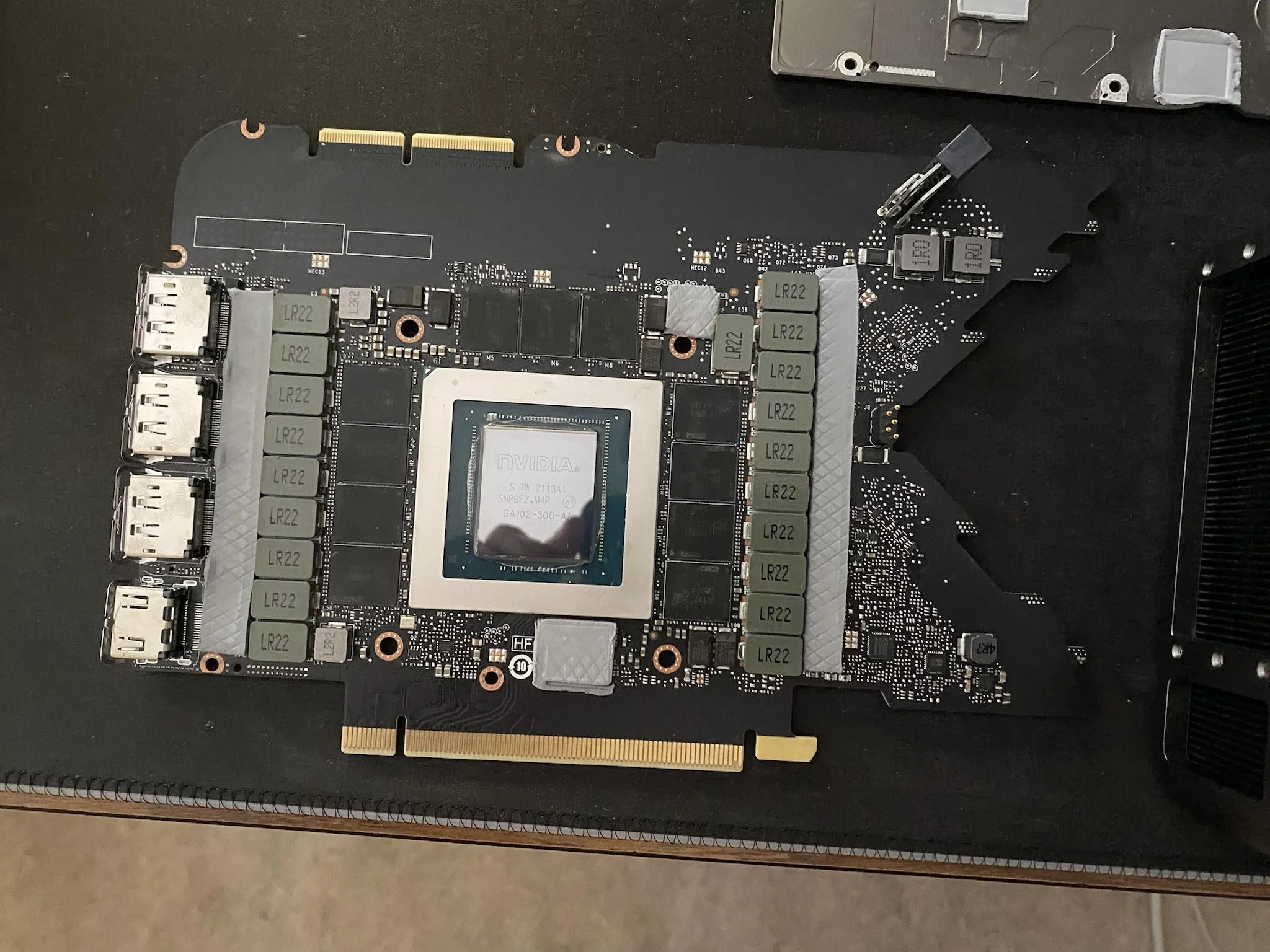

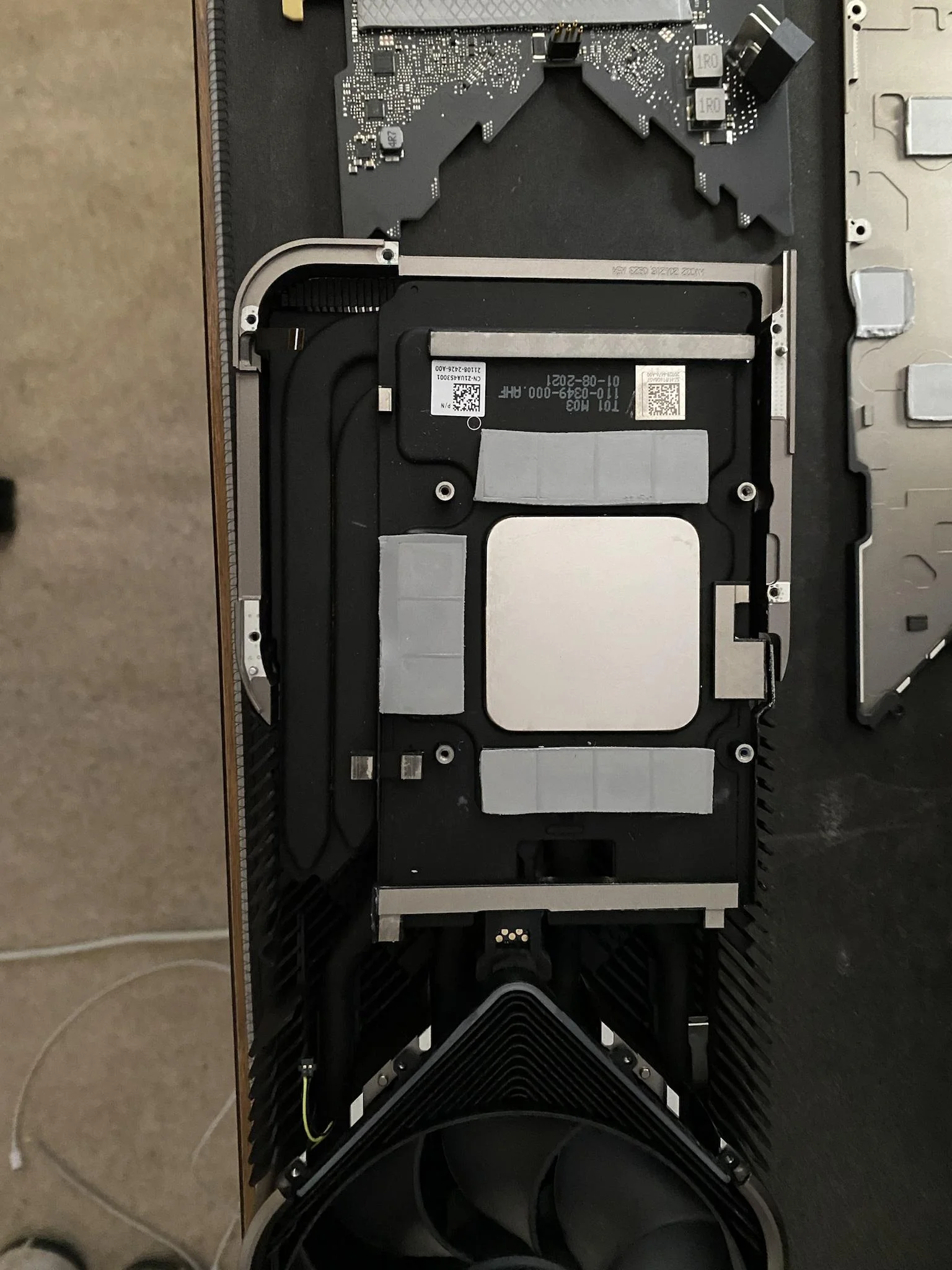

I recently changed the thermal pads out on my RTX 3090 FE as it would heat up to 104 degrees on my memory while mining for a short while. But my card runs at 102 degrees on the memory now so it didn’t make much of a difference.
Could it be because my gpu is so close to my cpu cooler that there isn’t enough airflow to cool the memory chips? The only other thing I can think of is that I used my fingers to place the thermal pads and apparently that effects performance.
The idle temperatures seem to have improved 31 degrees on the core and 40 on the memory.
You didn't apply the thermal pads properly, or used the wrong ones, if your still reaching 102DC on the VRAM.

I took it apart again to take photos of the thermal pads, I can’t see that I’m missing anything. I used 1.5mm thermalright odyssey thermal pads for the front and back.
