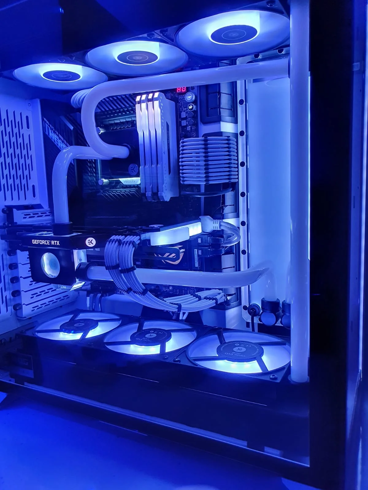

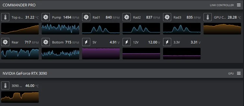

My First Loop
Case - BeQuiet Darkbase Pro rev 2 (inverted layout)
Fans - Noctua 140mm Chromax Black
AIO - Corsair H150i Pro
Custom Loop
All EK Parts, including Zotac 3090 GPU Block, Backplate, Radiator, D5 Pump combo, 3m of 10/16 Zero Maintenance Tubing, Black Nickel Fittings & Drain Port tap.
Only waiting for adaptor leads for the RGB on the flow indicator, pump and GPU block.
The Corsair AIO only cools the CPU and is mounted at the top.
With my next CPU/motherboard upgrade I'll replace the AIO with an EK CPU block and a better radiator at the top.
The front radiator has 2 fans on the front of the case pushing air in, and another on the inside that you can see on the left side of the image below.
I wanted to have another fan below that but couldn't do it without modifying the case (which I just didn't want to do)

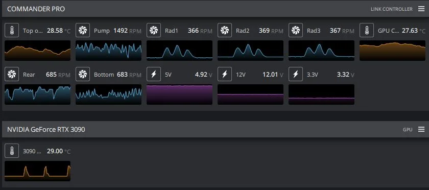

Temps During idling
Temps after loading CP2077 (3840x1600 all settings maxed with dlss auto) and starting a 5 min playthrough
The "Top of Case" temp shown, keeps going until about 35 degrees and then evens out.
The "GPU Cover" temp is taken between the Acetal covering and the circuit board on the front side.

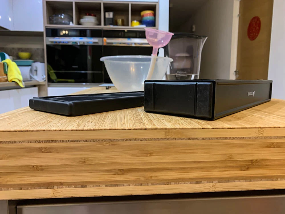

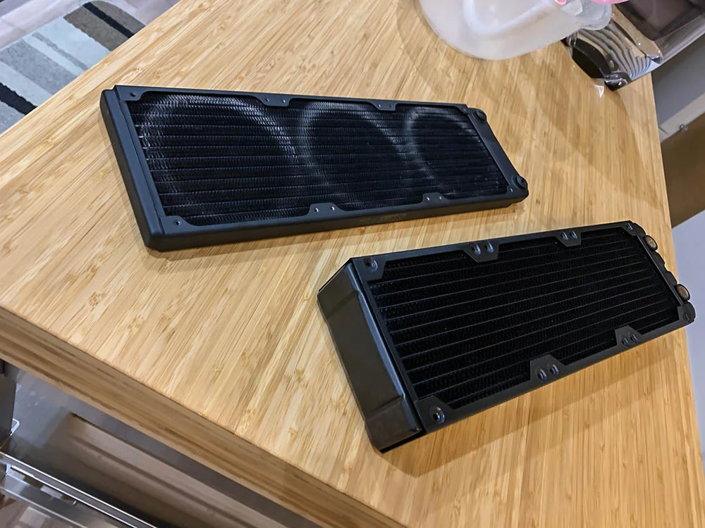

Here's my results from a few months back using insurgency sandstorm as a baseline with an Alphacool block:
Note: CPU and GPU are in separate loops so results are not skewed by cpu temps/activity.
Old setup 20mm thick radiator: GPU temp - 55c (Max spike 57c) / Fan speed 70%
New setup 55mm Corsair XR7 radiator: GPU temp - 46c (Max spike 48c) / Fan speed 55%
The most important thing for me here is the fan speed, its so much quieter than before, im over the moon with the outcome.
Give you a feeling of the size difference between the 2 rads lol, its monstrous! I'm glad i didn't go for a 60mm thick rad though, theres literally a 5mm gap left and it probably would have touched.

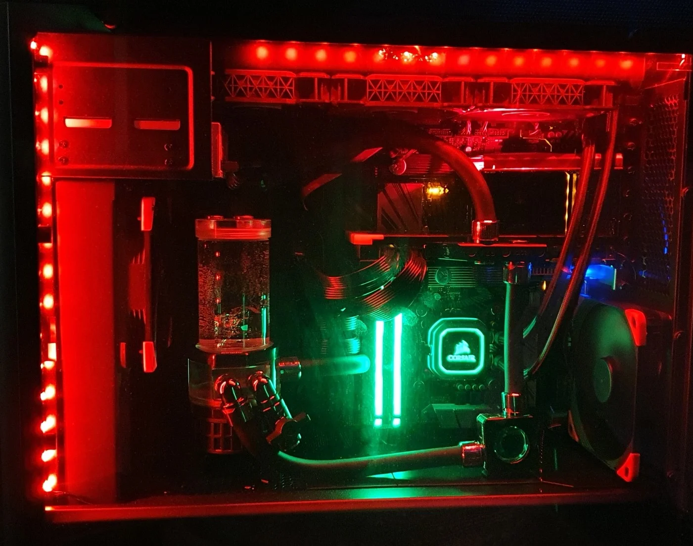

My First Loop :)
Custom Loop

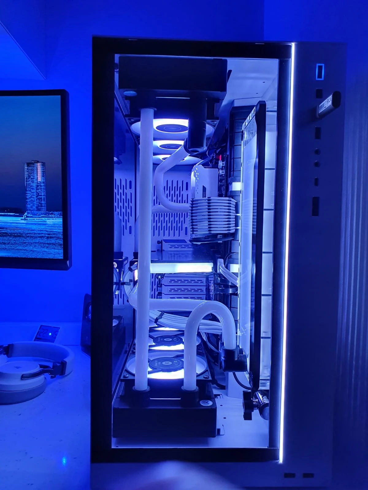

Hi Mate,
I changed direction and did a new build in the O11D XL as I felt like a change, I did however but the XE and offer it up before I switched path and it was hella tight. I was going to modify a 120mm bracket so that the holes off the pump holder which connect it to the original bracket line up which would give around 15 - 20mm move wiggle room, doesn't sound much but it changed the mounting possibilities dramatically so it is doable with a little modding.
I regret sending the XE back and swapping it for the PE now though as I underestimated how much room I had to play with for tubing off the FLT 360 :(
