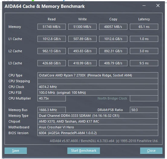

I got around to replacing my 2700x's stock cooler with a H100i GTX AIO yesterday, I was unable to do certain stress tests like Prime 95, Timespy's extreme & Firestike's extreme with the memory at 3200mhz 14.14.14.31, They'd all crash within a couple of minutes, so I dropped the memory speed to 3000mhz with the same timings and it no longer crashes. I haven't tried overclocking it yet and probably won't bother unless we start seeing gaming increases that make it worth while. As it is all I need is the memory sorted & then I'm happy with it as is.
With the Prime 95 the H100i temps maxed at 60 degrees which is good compared to the mid to high 70's the stock cooler did yesterday, that said it was only a 10 minute test so I'll leave it running for longer later.

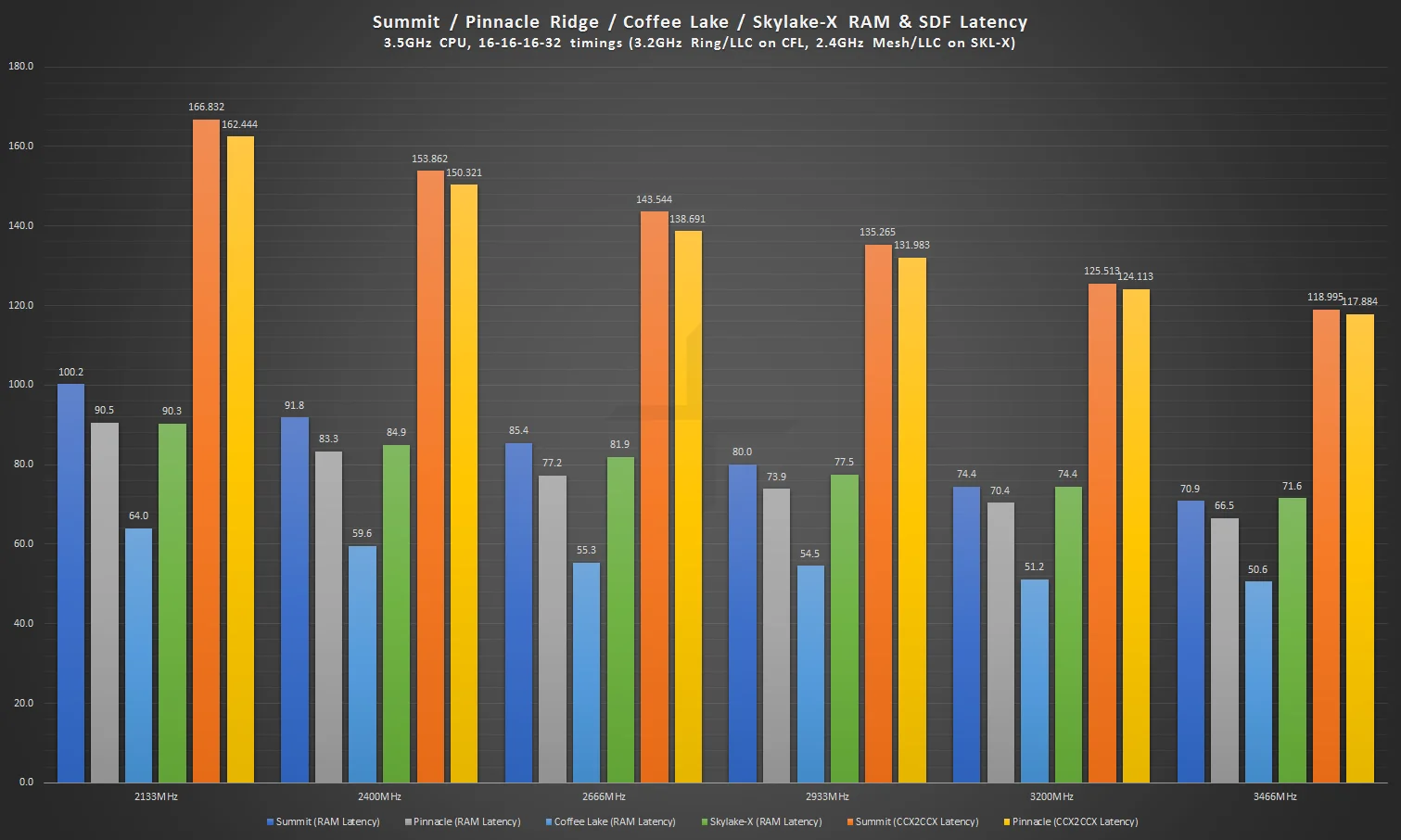

The memory controller in ZEN+ (credits by The Stilt)
The memory controller in Pinnacle Ridge is identical to the one found in Raven. There are some differences in the software configuration, however the Phy IP itself is no doubt identical as the two share the same controller firmwares.
Compared to Summit Ridge, the revised controller in Pinnacle Ridge provides < 8.7% lower access latency on average (2133-3466MHz). The latency difference is largest at =< 2666MHz frequencies and starts to tail off at higher speeds.
Likewise, the SDF latency has slightly benefited from the changes. The average latency improvement (CCX2CCX latency) is < 2.2%, but just like with the memory latency the difference is tailing off as the memory speed increases. At 3200MHz MEMCLK the SDF latency difference almost falls within the margin of error.
Despite the extremely welcome latency improvement in Pinnacle Ridge, the memory latency is unfortunately still < 38% higher on average (2133-3466MHz) than on its closest rival from Intel (Coffee Lake).
While the changes to the memory controller in Pinnacle Ridge do provide lower latency, unfortunately the highest achievable memory frequency seems to be exactly the same as on Summit and Raven Ridge parts. A realistic expectation would be 3400 - 3533MHz depending on the silicon quality, the motherboard and the DRAM modules used. Some CPU specimens featuring an exceptional memory controller might be able to reach 3600MHz while maintaining true stability, however all of the tested 2700X samples were limited to 3400 - 3533MHz on both Crosshair VII Hero and MSI B350I PRO AC motherboards, regardless of the settings or the memory modules used. The stability was determined using “Ram Test” utility, which obviously sets the bar for stability a lot higher than the tests methods other reviewers typically use to deem the memory as “stable” at certain frequency.
On the tested samples, the distribution of the maximum achievable memory frequency was following:
3400MHz – 12.5% of the samples
3466MHz – 25.0% of the samples
3533MHz – 62.5% of the samples
There are clear differences in how the memory controller behaves on the different CPU specimens. The majority of the CPUs will do 3466MHz or higher at 1.050V SoC voltage, however the difference lies in how the different specimens react to the voltage. Some of the specimens seem scale with the increased SoC voltage, while the others simply refuse to scale at all or in some cases even illustrate negative scaling. All of the tested samples illustrated negative scaling (i.e. more errors or failures to train) when higher than 1.150V SoC was used. In all cases the maximum memory frequency was achieved at =< 1.100V SoC voltage.
AMD has revised the memory layout design guidance with Pinnacle Ridge targeting motherboards (i.e. 400-series) in an effort to potentially make the higher memory frequencies possible.
While this might theoretically improve the frequencies on some motherboards, generally the frequency limiting factor is the memory controller itself and not the topology the motherboard uses for memory signaling. Because of that, the newer 400-series motherboards alone should not be expected to provide improved memory frequencies at least by a significant margin.
