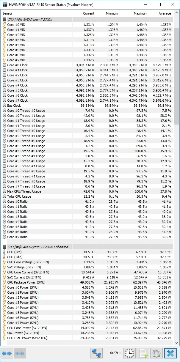

So... without touching anything (except DOCP set on memory) I get cores happily stepping up to 4.34ghz (most I think I've seen was 4.347, basically... 4.35ghz boost is working). However, the core VID on each can be as high as 1.494v max (average is VASTLY lower, more like 1.36v
Anything to be alarmed about? That's all completely stock. It's under water and temperatures top out at 64.7 tctl and 58.4 tdie, just... seemed a bit high on voltage?
SS from hwinfo:
From what I've read, they're only split second jumps to that voltage, if you check them on load they stabilise (or at least for me) at something like 1.3Xv
Yeah those voltages are fine as it's for short periods and only on a couple of cores at a time, it's perfectly fine stock behaviour.
Most likely not. My 1600X scared me with voltages for the first few weeks, but a lot of reading around drove me to the conclusion that this is how XFR works, and it is why you can't get an all-core overclock as high as XFR can boost a single core. AMD say it is completely normal, and I've seen people posting as high as 1.6v spikes. Mine tends to cap at 1.525 under stock speeds.

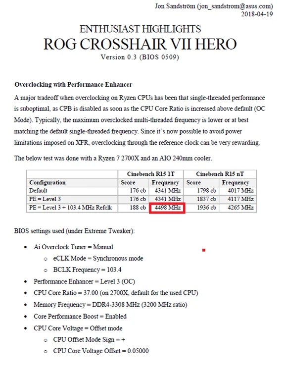

The Prime Pro x370 has Core Performance Boost in the bios but no Performance Enhancer.
I'm not sure if the CH6 x370 has it?
If it doesn't that alone set to level 2 on a CH7 would according to an article gain you 200MHz across all cores.
This was alt+tabbed while gaming so yeah the "current" looks fine. Ty, figured would be a minor spikes thing.

In my case, it seems to. All ok until I try 101 BCLK, then it's locked at 37x multi. Change it back to 100 and all is well again... Guess I'll be leaving it at 100 then!
Nah you are doing it wrong. I have bclk 101 and the boost works correctly. :)
To use bclk change and have it work you need to do similar to the following. (However the voltages required for the settings below is quite high)
