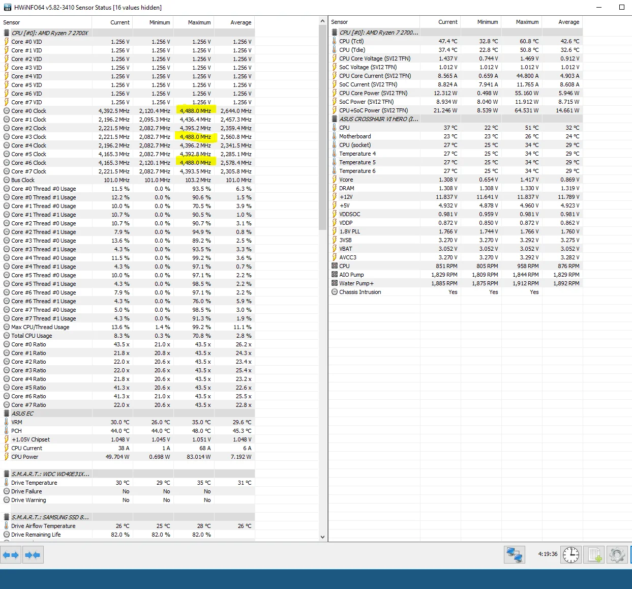

All core clocks seem a little outdated given the boosts this thing can do. Only advantage seems to be capping the voltage lower but even so mines doing 1.25v all core at 4114. Single core does hit 1.469 but that seems well within Ryzen + tolerances.
Bizarre, had some cores boosting to 4488 today.....:eek:
Ye but You are not 100% stable are ya :D
Look at the Bus Clock maximum table, it reads 103.2Mhz which shouldn't happen under any circumstance considering you seem to have it set to 101Mhz. It's just a reading error on the Bus Clock and since Core Clocks are calculated based on Bus Clock x Multiplier, it gives you 103.2 x 43.5 = ~4489Mhz. HWinfo will probably get an update to fix that.
Makes sense. :) Max legit clock still 4393 then. :p
