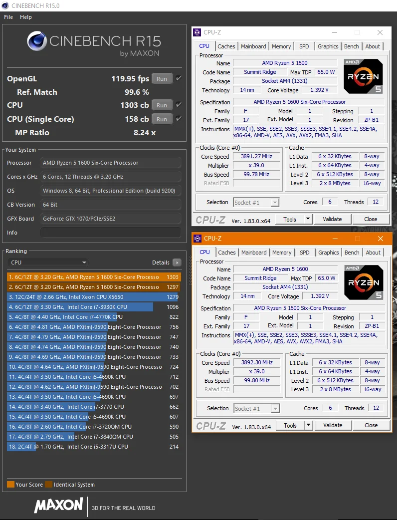

What memory speed and timings. 170 is quite low no?
Yeah that's another thing I can't get my head around. 3200 at CAS 14, 1.35volts
I see other single bench scores way higher. Such a strange beast the Ryzen
Adjusted my offset to 0.1 and now have a 171 single score, but the boosts are lower. Gah!!!
Ryzen mem calc program, docp is crud.
haha oh dear. Just page-faulted out at 3200MHz and refused to reboot. Back to 2133MHz.
Yeah, ok, my RAM won't run at it's rated speed either...

Yeah, I was running 0.05 over anyway - 1.355v. Might try a tickle more and see what happens.
Anyone know the absolute maximum?
Great, thanks. I think it's on the brink at 1.355v. As I say, it's been running fine for the most part...1.45v for daily with b-die, you have plenty of room to push that.
