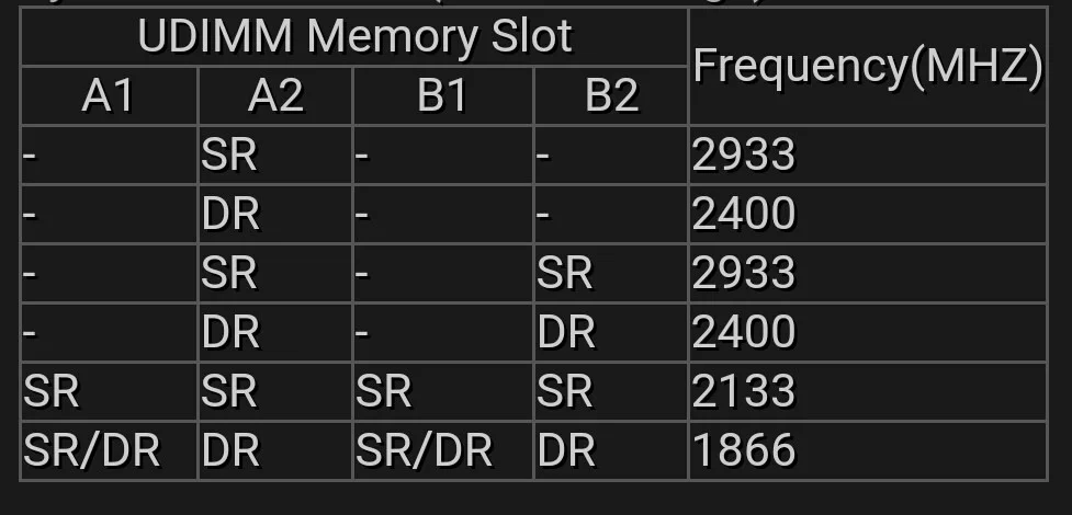

Just as an example of the impact that SR/DR RAM and having 4 dimms may do for memory speed:
Obviously they are not maximums, but do indicate the kind of speed penalties that could occur depending on your choice of memory config
This table was taken from the spec page of the top x470 board from Asrock
