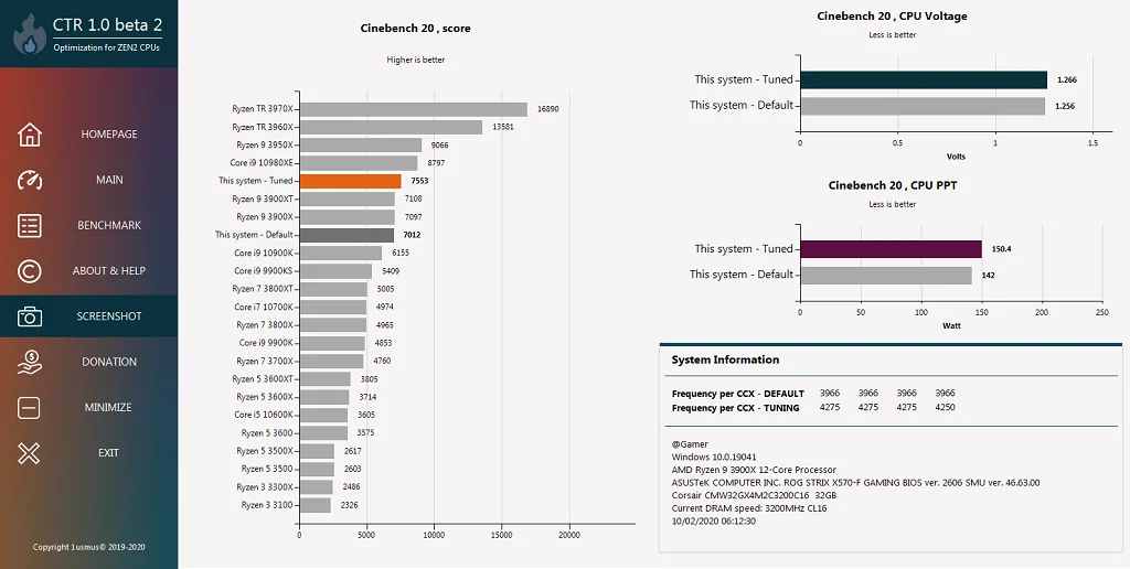

Another silver 3900X here and very similar to Brizzles results.
Asus X570 motherboard initial run showed some LLC warnings during the diagnostics phase but no issues. Cores were spread from 4250 to 4375.
Change to LLC4 in BIOS and warning went away, vdroop dropped to ~1.5% however the core spread closed up with a tighter average but less peak on the two best cores. The CB20 score did go up however and the temps were lower and more stable like many have found.

Benchmark after enabling LLC4 in BIOS

Just tried Beta 3. Appears a bit more aggressive on the clocks despite a note saying the LLC warnings would be less frequent I had my first reboot with ASUS - LLC3.
Went back to LLC4 which is a bit more aggressive and ran through the process. Previously the LLC 4 gave a more balanced core OC but this time it kept upping the CCX clocks until each block failed. Ended up with the improvements below.
CCX1 4275 - 4400
CCX2 4275 - 4400
CCX3 4275 - 4300
CCX4 4250 - 4250 (Lame!)
1.256 vcore
CB20 score went from 7553 - 7665 on my 3900X (silver)
Now running some game benchmark loops to verify the stability.

I don't usually play with the minutiae but that core spread on my result bugged me a bit so according to the Guru3D article +.25mV should net +50Hz on a core so I set my target to 1275mV and manually set my CCX frequencies (edit profile). Really just to bring up that lame CCX and see if it worked which it did. Just need to game again for a bit to test stability.
LLC4 - B2 - B3 - B3 (+25mV)
CCX1 4275 - 4400 - 4400
CCX2 4275 - 4400 - 4400
CCX3 4275 - 4300 - 4300
CCX4 4250 - 4250 - 4300
1275mV
CB20 score went from 7553 - 7665 - 7711 on my 3900X (silver)
