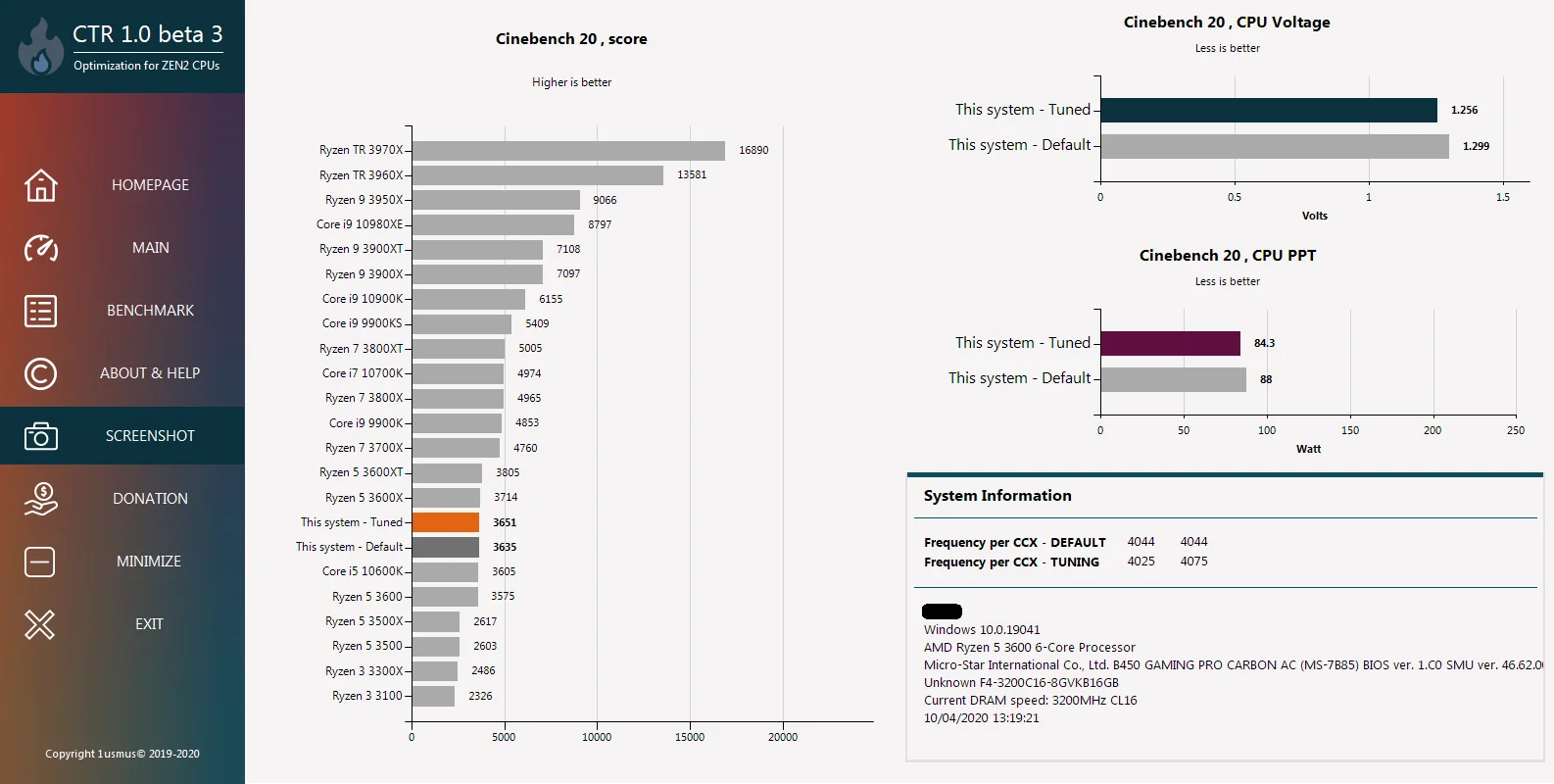

Not a great result with my early batch 3600. This is with an Arctic Freezer 34 eSports Duo cooler with the CPU topping at 65 degrees on the benchmark run. Memory is G.Skill Ripjaws running with the default XMP profile.
I ran mine today, got 1256mv at 4350mhz.
I reckon I could push 4.4 with a zero or a very small vcore increase.
Score is 3679
