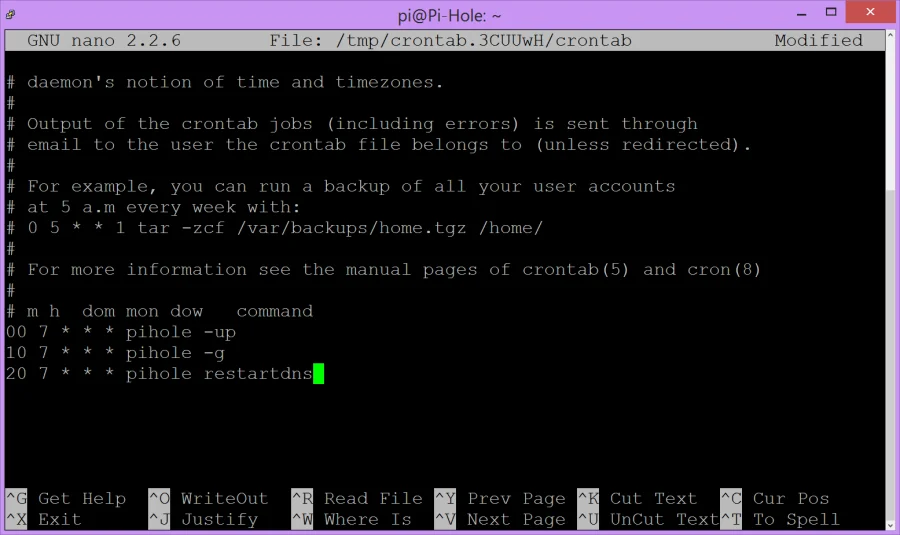

Another question - should be an easier one :) I have set Crontab (task scheduler) to update Pi-Hole every day at 0700. Shall I use all 3 lines or just the 1st one? 1st line is to update Pi-Hole at 0700, 2nd line is to update the ads definition file at 0710 then restart the DNS server at 0720. I'm just not sure whether pihole -up includes the ad definitions as well or not.
I'd be a little wary of doing -up in that way, there was a release not that long ago that set a password on the web interface and if it wasn't for me seeing the output of -up on the console I wouldn't have known and would have had problems logging into the web interface until I found how to change, or remove the password.
I do schedule an update of the block lists but rather than doing two separate comments through crontab which would potentially leave you without DNS for up to 10 minutes I have both commands in the same script so they fire one after the other without a gap.
Code:
#/bin/sh
/usr/local/bin/pihole -g
/usr/local/bin/pihole restartdns
That script is called /root/pihole_update.sh and that's called at 4am by crontab.
Code:
0  4    * * *   root    /root/pihole_update.sh
It effectively does a pinhole -g itself on a regular basis. I don't bother with any of the above although as said previously, I do have an alert via PRTG to tell me if there's an update available so I can go and grab it manually.
I don't think there's any need to manually restart the dns service either, -g does that at the end of the process.
As per others, I'd advise to not have the pihole -up set on crontab.
I had got it set to go once a week on my second box but that thing had it's own problems.
If you feel you MUST have an update run periodically then simply pihole -g is enough to run daily.
