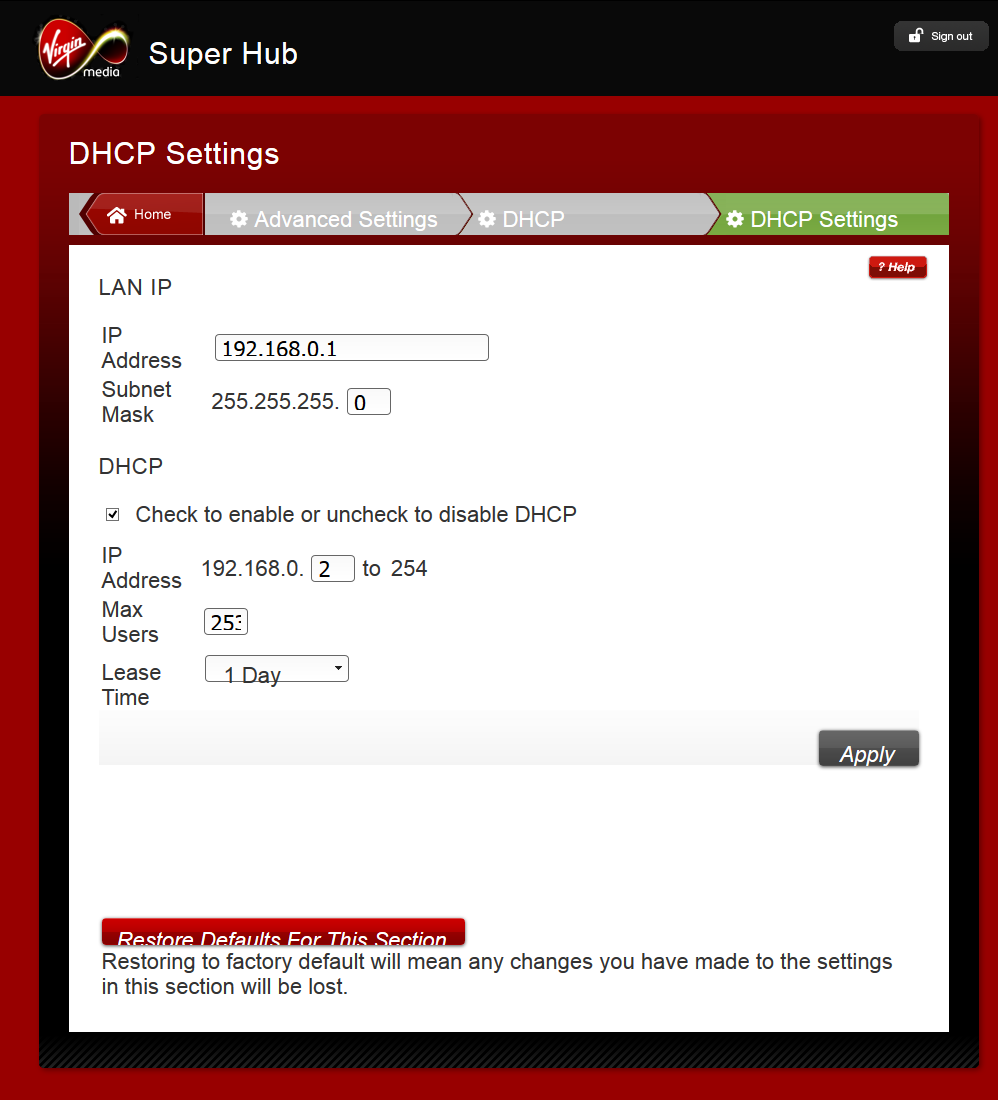

I'm in the DNS part of my VM router/modem and I can't see where I can enter in a primary / secondary DNS. Does anyone else here have a VM Superhub, and know how you enter in the Pi-Hole's DNS?
Don't think you can on the superhub, disable dhcp on the superhub and enable it on the pi.
Thanks!
I did that - turned DHCP off on the Superhub, then enabled it on the Pi. I also set the Pi's address in Windows networking DNS settings as 1st choice, then Google DNS as the backup / 2nd choice.
