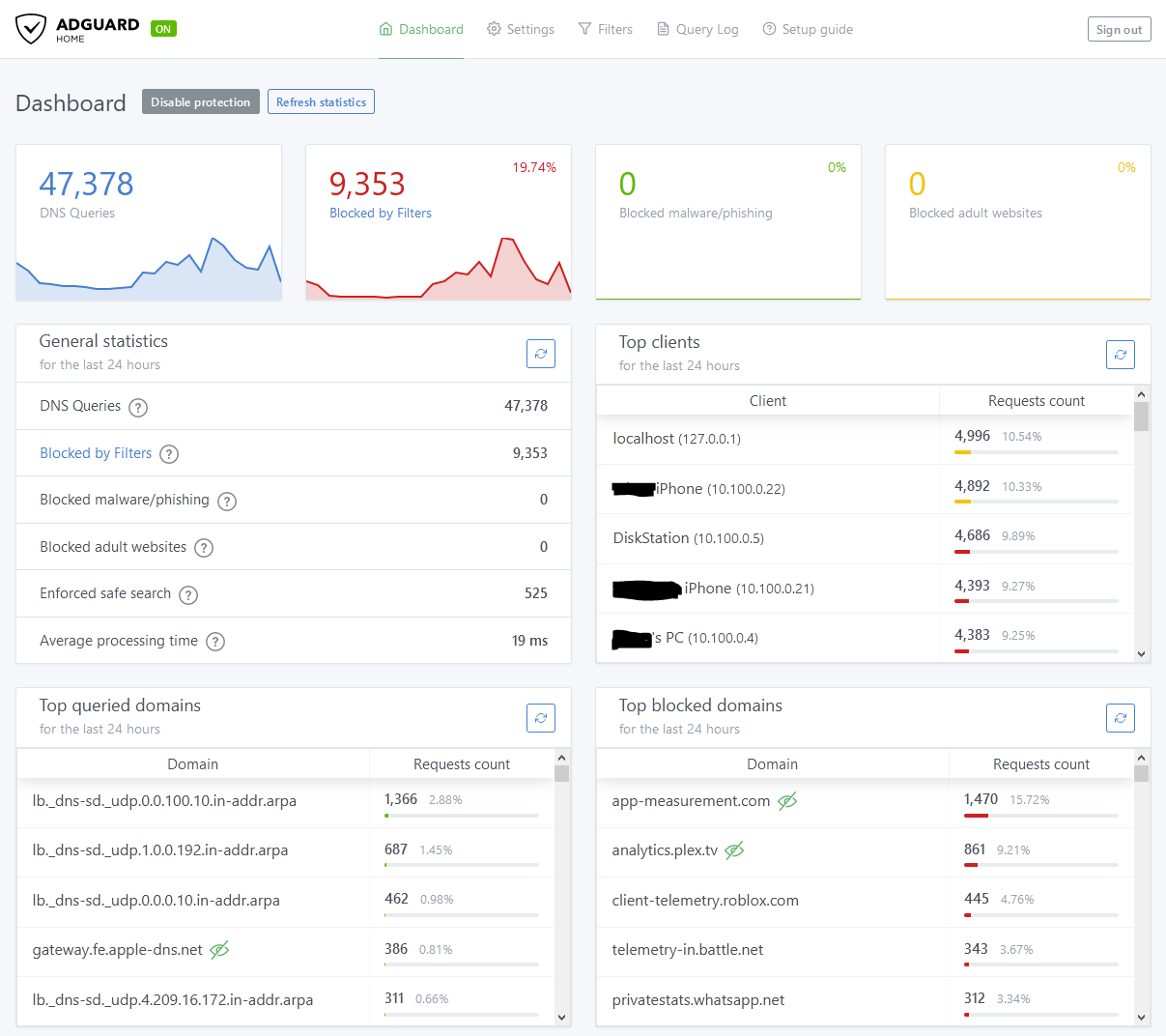

How are you chaps getting along with running only oisd.nl #1 block list? It's been a few days now and I'm curious.
Still doing great for me, I swapped to it as my sole list ages ago now and it never lets me down:
Edit: Derp, just came back to the thread and saw the pic was inserted twice.
