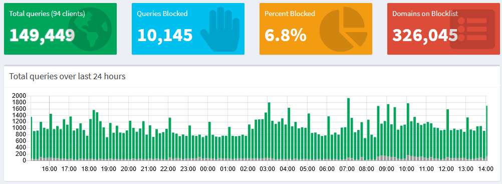

To illustrate it, prior to be installing a bunch of IoT WiFi LED downlights the split between my 2 Pi-Hole isntances was probably 95/5 weighted towards the primary. Now it's about 65/35 weighted towards the primary.
Primary over the last 24 hours:
Secondary over the last 24 hours:
The difference in the client number roughly equates to the number of iOS, Windows and Android clients in the house.
Looking into the Pi-Hole logs, nearly all the queries hitting the secondary Pi-Hole instance are from my IoT VLAN. There's still some queries from VLAN1 but I dn't see anything from the Windows, Android or iOS clients but ti seems the a Sky Q box likes to make use of both servers.
