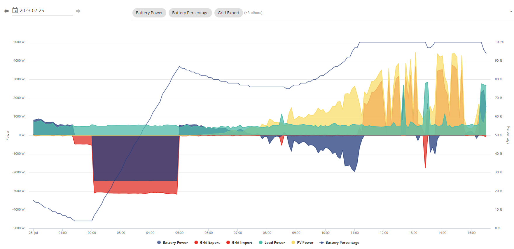

Also anybody else here wth Givenergy take a look at this, something really seems off since I use ~15kw per day, ive sent an E-Mail off to installer.
Info just keeps being repeatedly wrong, this is right now and since battery was empty solar to home shouldn't be 0 and consumption and grid to home are massively different.
Is yours at all accurate for monitoring usage?
Yes mine is relatively accurate showing Home = Consumption data, Generation = Solar in, and then Grid In/Grid Out useful appropriately.
Do you have gaps in your data? If the inverter dongle goes offline it can lead to weird chart things.
Check the Power Flow chart instead and make sure all the data is being fed in at 5 min intervals without strange gaps. If the chart is gapping it's likely the inverter is not remaining online consistently so far as internet reach goes.
This is what I got and what ive contacted GE about today

Edited, had wrong image. I got battery set to charge via solar only atm.
My experience is that the data gathering is dodgy, its broadly accurate but also not that accurate if that makes sense
Yeah, think im going to have to go down another route, before I was keeping track via the IHD for smart meter but obviously thats not possible anymore lol.
Inverter keep going on and offline and lots of timeouts when trying to change anything ive spoken with installer and lobbed GE an email as it could be anything from ct clamp, inverter issues, I think its reading the stuff fine on the meter data side for import/export and solar and whatnot its just the timeline stuff.
Not sure if its a straight up issue with inverter, ct issue depending on whats in it or a communication issue, if its communication issue then trying to go from wifi to lan may sort it out but I have now lost home connection for some reason, it was working fine since I updated app yesterday and had no issues until the last couple of hours.
Its been quite weird.
