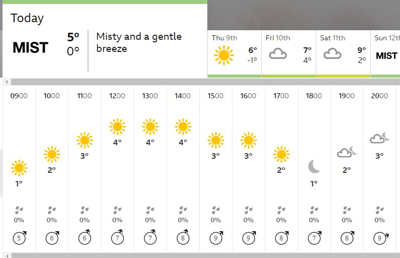

Today after the foggy start it managed 14.5kWh - that’s against a forecast of 19kwh.
Wasted 2kwh to the grid where the packs were so cold which is a shame but not too bad.
