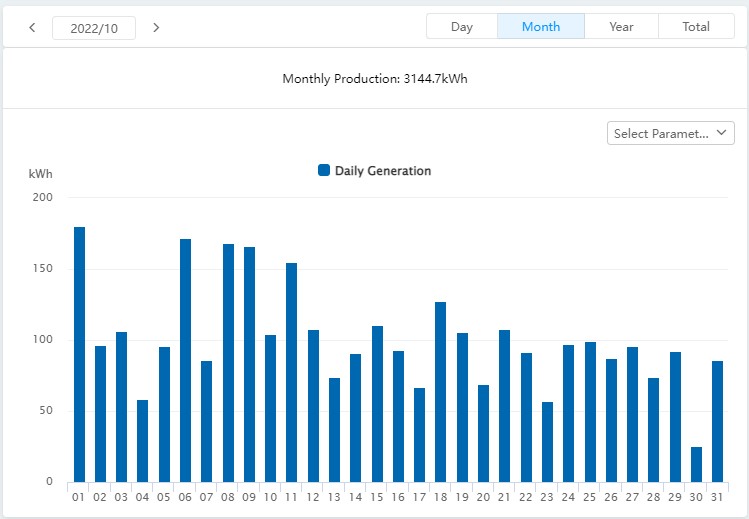

393kwh in October - the location stays.... ;)
It occurred to me today that Kent, is indeed sunnier....................... :D
Yes that really is 3144.7kWh generated in October, in sunny Kent, we have 200 panels on the roof at work, which equates to 50 kW of panels.
But, 3144.7/50 = 62.9kWh per kW of panels.
At home I generated a measly 1.21kWh today, at work 16.1kWh with 12.5 times the amount of Solar
