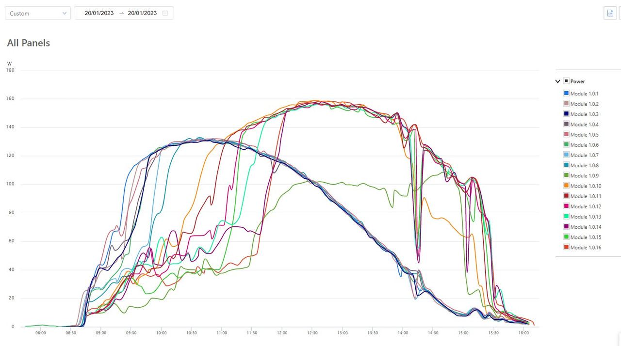

When they fit the optimisers they should record the serial numbers (they should know this anyway), these can then be used to create a layout, so I can even see how much power each panel has generated.
Here's a per panel graph I did the other day
How did you get that graph? I have Solaredge as well but can’t find this on any screens?
