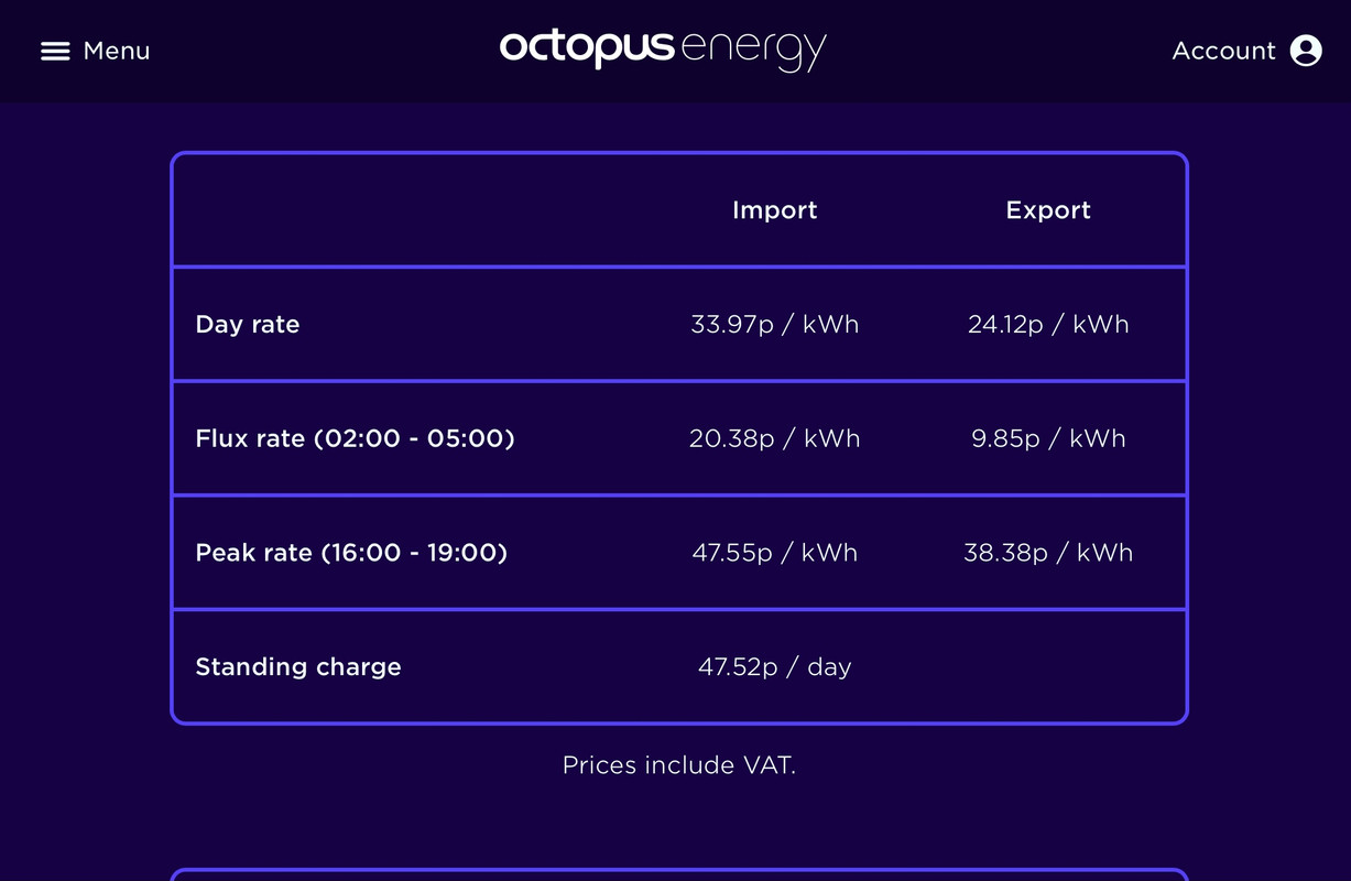

I'll re-visit in a bit, but not too worried, worst case I'm on Go and off-peak is extremely cheap currently. If the rates stay the same I'd probably look at switching over early May, because by then I think I'll start heading into more generation territory and less requirement to rely on Go off-peak charging.
Seems I've lucked out on postcode as well in terms of standing charge and export. Otherwise it's a little higher than you from the grid.
yeh it does seem there are a few regional differences…..24p a lot better than 15 though and im guessing during tye peak of 4 til 7 come end of march we will be exporting rather than importing.

Indeed, actually makes sense to fill up the car from flux and export maximum amounts during the day. Could easily get through the 4 to 7 without using anything and in the summer I'll still be doing good generation until 6 or so!
Will look to move over to octopus next month and hope it's available.
Flux makes the most sense if you export a lot, particularly if you export more than you import.
As soon as you add an EV into the mix (unless you have a huge array) and go/intelligent is probably the way forward.
Yes that's the conclusion we've drawn as well so it's good to hear that being interpreted from others. :)
Also although not always that sensible I like to be an early adopter it's in my nature to try stuff out! :D
Besides you can always move back to a different tariff if it doesn't work out for you.
Those of you with EVs I don't really know the benefits of Go other than cheaper night time charging? So probably doesn't make sense to switch since I guess charging an EV means you'll basically never really have export to give?
