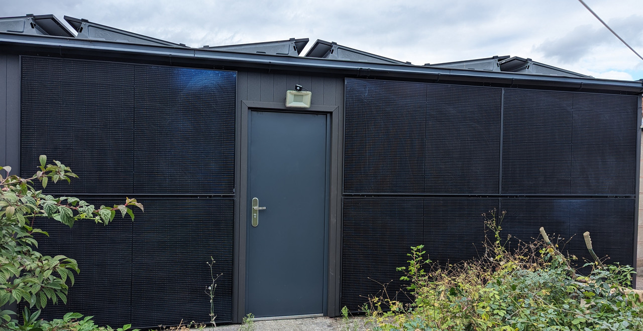

I'm surprised how well the the garage side wall ones are performing.
Presume these are mounted at 90 degree's, so vertical?

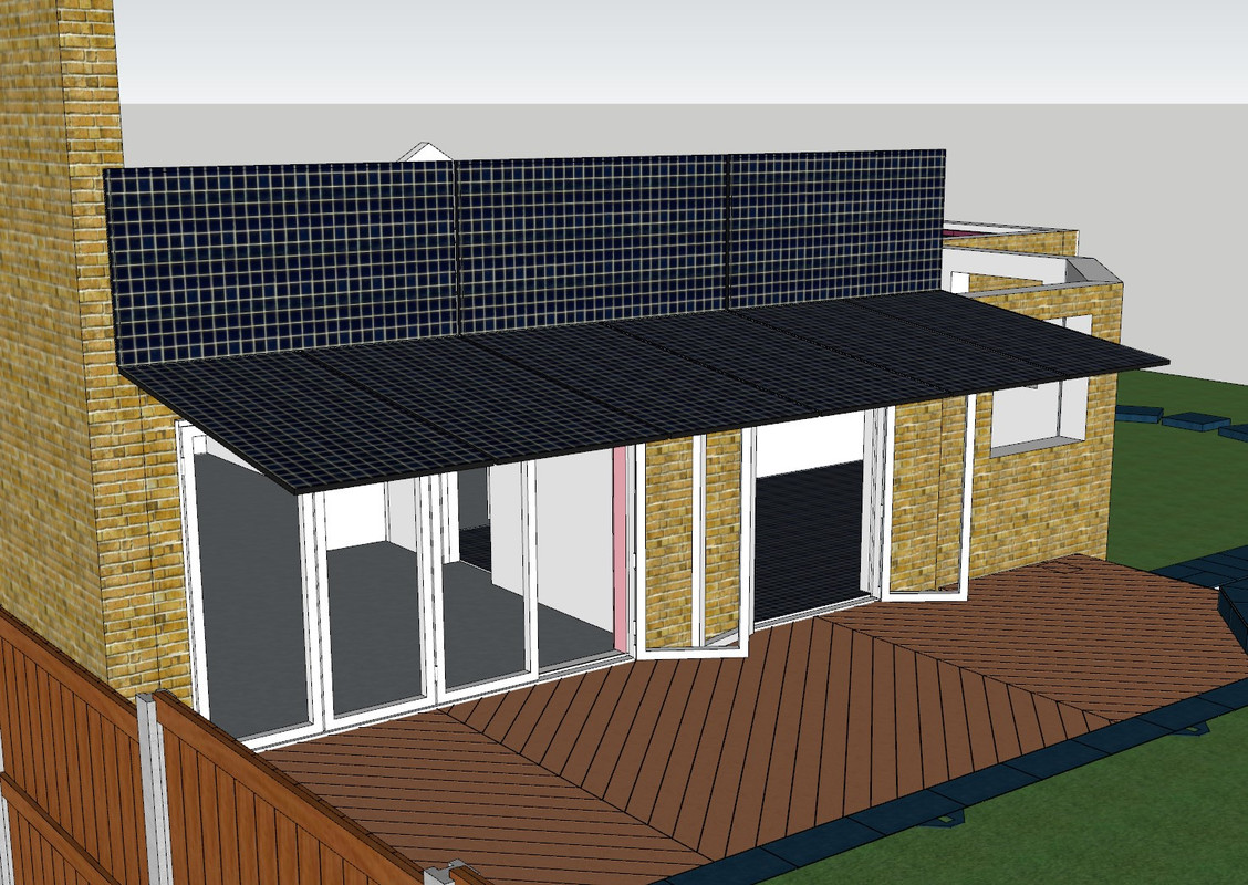

I'm thinking on doing something like this, not so keen on this design, but its 9 panels (460w Bifacial)
Problems with this design, ladder access to rear of house, potentially makes the lounge darker, generally more in your face, and more prone to wind damage.

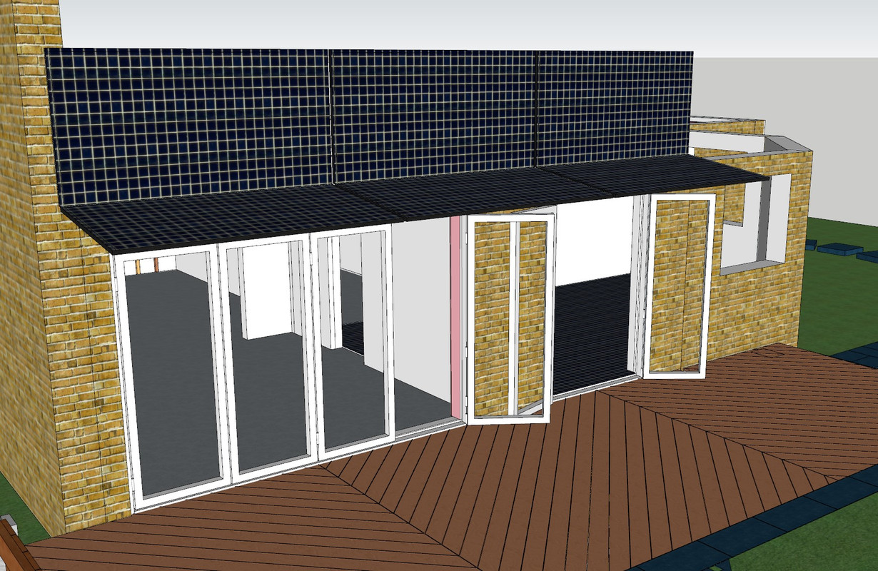

Note: I've never got around to drawing first floor of the house, but the top panels would sit just under the upstairs windows.
Or this one which I think works better, and is less prone to the problems of the above, but only six panels.
The first picture with 6 panels only would be the way i would go and you could build them onto a sliding tray. So they could slide out and give access to everything above for the very few times you might need and can still give you power after being slid outwords.
if you catch my drift
The first picture has a total of nine, sodo you mean the second picture which has 6?
Sliding them outwards would put a lot of strain on things (too much), and would be very hard to get ladders in, initial thoughts was to build the frames so that single panels could be pivoted downwards for the few times I'd need to get ladders up there. Just loosen the bolts remove the outer arm bolts and the panel would hang down against the building.
Yes, that's correct, 90 degrees, I have six 2 rows of 3 landscape in this area, I'll find a photo shortly
I did look at a similar option to you, but on the garage, but in the end just settled on the vertical ones.
Edit: photos, please ignore plants etc, work in progress!:
That's nice, they blend in really well.
no - i was thinking the first picture without the 3 vertical ones....so just the 6 as a canopy over the deck, but the canopy could pivot forward as a unit giving you space in behind if need be for ladders.
