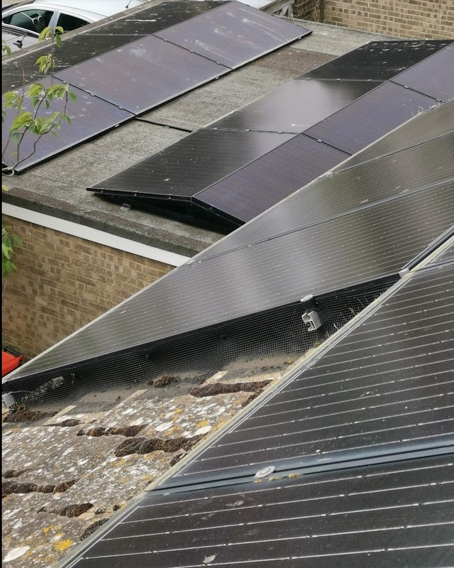

Guess what I spent my bank holiday Monday morning doing :mad: At least it was dry.

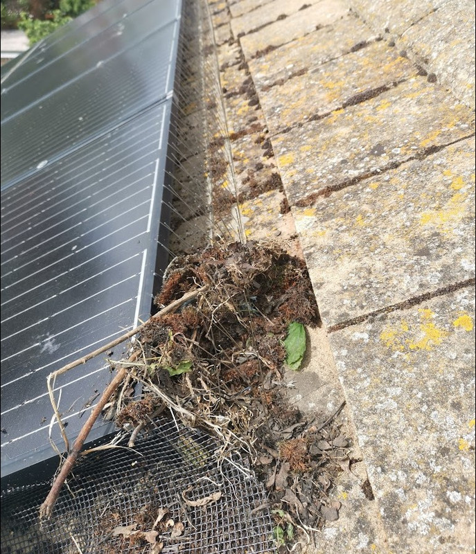

Now we've all got used to getting bird netting put around our panels, but it seems the birds (Seagulls I think) are adapting, they are now trying to build nests between the panels and the ridge, and what's more unbelievable is I've actually got a double row of birds spikes, which I installed quite a few years ago.

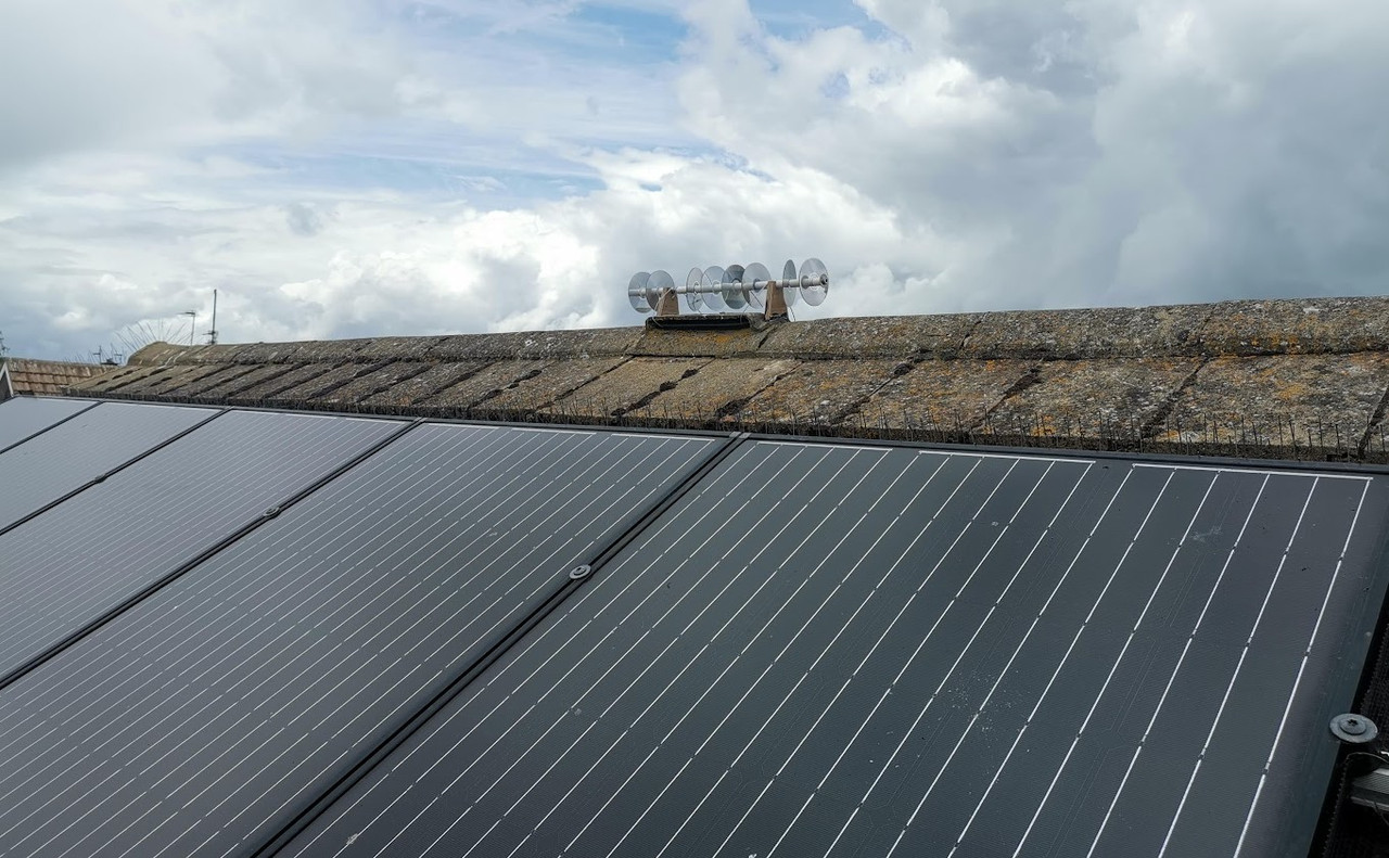

I've cleared this (again) and have added what is hopefully a deterrent, the seagulls also liked to sit on the top of this vent. It's old CD's and DVD's, hoping the shiny bits will ward of the birds.
There is also a deterrent called fire gel, so I'm going to get some of that for the main roof as well as the garage roof, as that keeps getting covered in lots of seagull mess, they then walk it around the panels :mad:
On a separate note, can't you move those panels together and fit some with the space saved on the flat roof?
