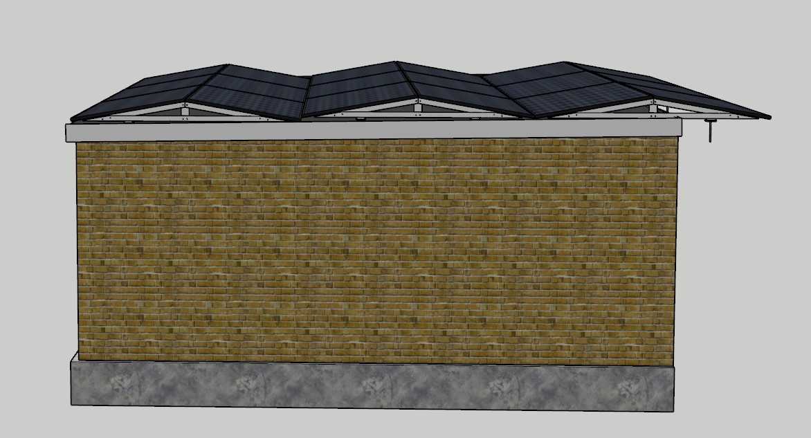

On a separate note, can't you move those panels together and fit some with the space saved on the flat roof?
As the regulations* changed late last year I could increase the pitch of the panels, and move them closer together, but still not sure there would be space for a third row. With increased pitch, and closer together the panels would also shade each other more.
Currently there is a 770mm gap down the middle, and the gap at the front and back is 300mm, so total gaps = 1370mm, it would be a lot of work, and cause other complications.
*Panels used to be allowed to be a maximum of 200mm above a flat roof under permitted development, this has been increased to 600mm.
I was thinking of just closing the gaps at the same angle and adding a further single row of 3 perhaps?
If it had fitted, I would have done it.
Edit. Would have worked with another single row of three, but causes other complications. Its currently 4 strings of three panels, wired in parallel as two arrays, add another 3 panels and it causes complications, it also means there is no easy access to the panels as no roof space.

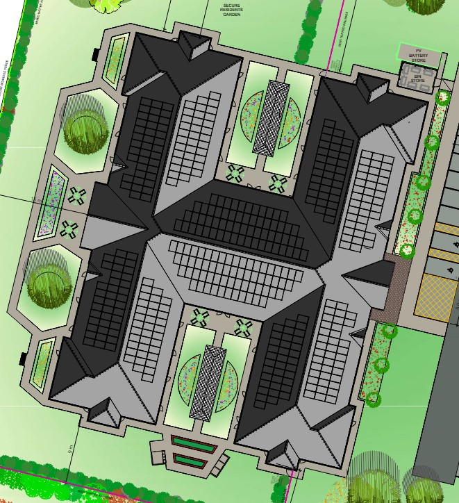

I'll help later, but it is frankly an utter disgrace that a new house like that, and those advertised on their website don't have a sign of solar on them, they must cost £500k+ and if they skipped the roof tiles they would have probably saved money. This country is utterly crap at getting anything done properly.
EDIT: There is a picture of a house on there with solar all over the roof, and it is obviously a 3D render as the panels are a weird aspect and there is zero mention of the solar in any of the available plots, which is even worse, if there really is solar they should be screaming about the bills saving since they are lumbering you with a crap leasehold that will cost you £3k a year in fees when the sell it out from under you.
My sort of retirement home, hopefully I'm a long way off needing it.
I can't see in the planning documents what they fitted or how many, but it does state they also install ground source heat pumps, a truly forward thinking company.
