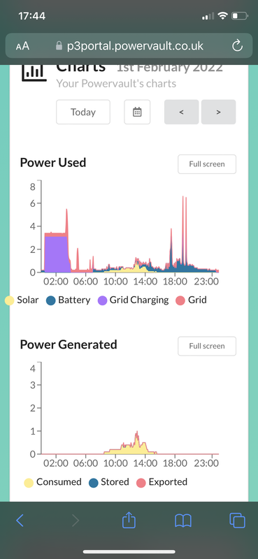

We generate very little in the winter so we have to pretty much fill up our battery with off peak electric. Off peak for us is 10p, peak is 23p. Week days is fine but weekends are tricky as we have no gas central heating just electric. Air to air source heat pump is worth its weight in gold for us though.
