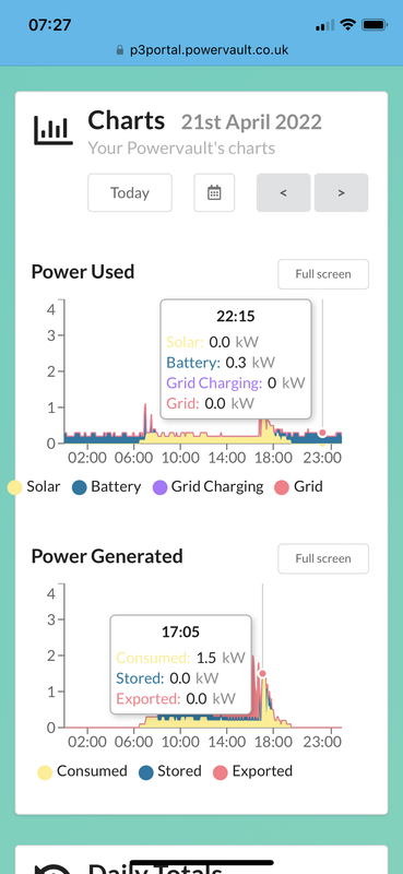

Been independent from the grid pretty much continuously since April 21st, would’ve been sooner but didn’t change my schedule soon enough.
Just get it done whether the maths work out or not, I get a warm fuzzy feeling knowing I’m not paying energy companies anything, especially at the prices they are currently charging.
